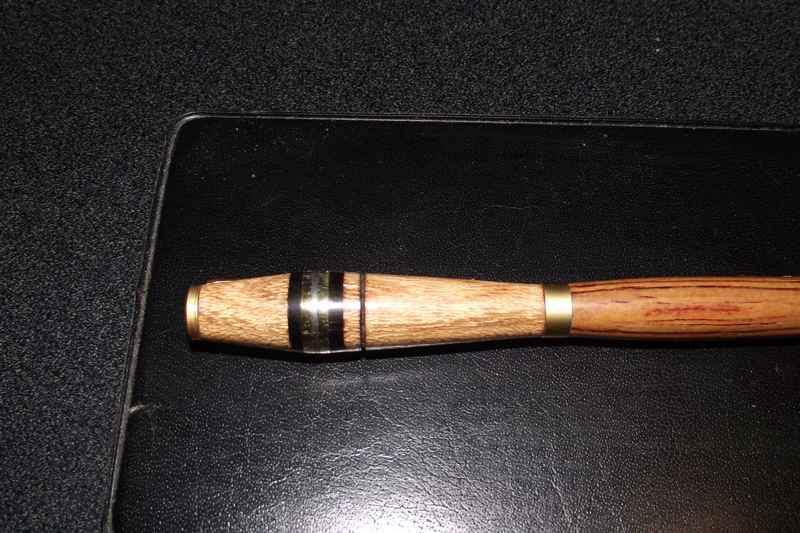

Ebony-brass-aluminum-brass-ebony sandwiched in this segment, glued each layer individually with medium CA, then generously applied thin CA all over. Turned with a Easy Wood Tools Ci2M tool. Sorry for lousy photo. Just finished the pen an hour ago and took the photo in a hurry.
