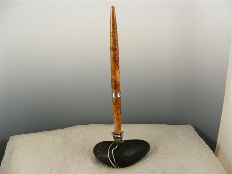

Sorry, no help here either. All that I have done(which is not many) I have modified one of the std. kits. This is the only one I have a photo of and it`s a modified slimline.

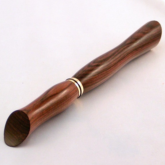

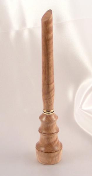

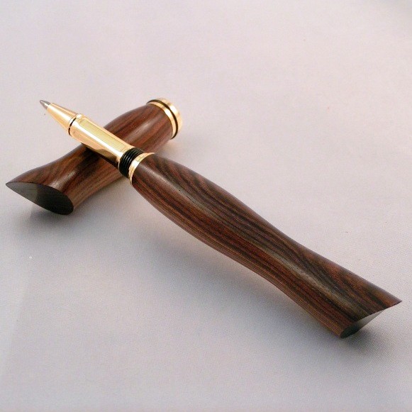

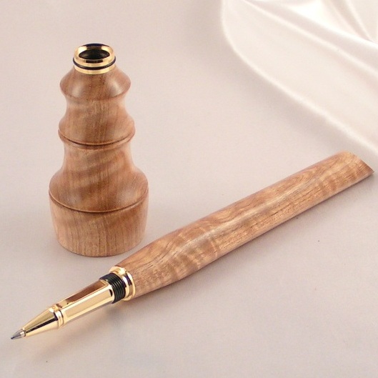

Ed, your work is always inspiring. I've made a couple of pens based off of what I learned from your DVD through AS that I got when I bought the Baron CE mandrels. I haven't done too many closed ends in the last year or so, but it's definitely fun to do.

I like Ed Davidson's making the desk set with the closed end pen (yup - I purchased also) -- but petrified wood is more rock than wood from the samples and pieces I have had in hand. So the shaping and polishing and drilling is more lapindary in nature than turning. Commercial "funnels" that fasten to a hole in the base are sold by several vendors, and a pen (commonly closed end) is made to fit the funnel.
Where Ed is suggesting a solution is to make the cap into the funnel and attach it to the petrified wood. Using the baron example, you can turn, carve, shape etc a piece of wood based on the baron cap, and make it to attach to the petrified wood with a tenon/hole, epoxy connection, etc.
Could be a fun experience -- be sure to share pictures.
