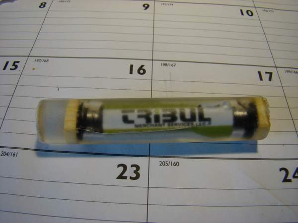

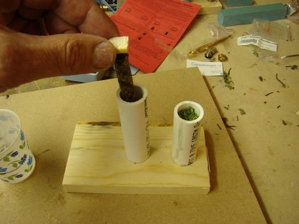

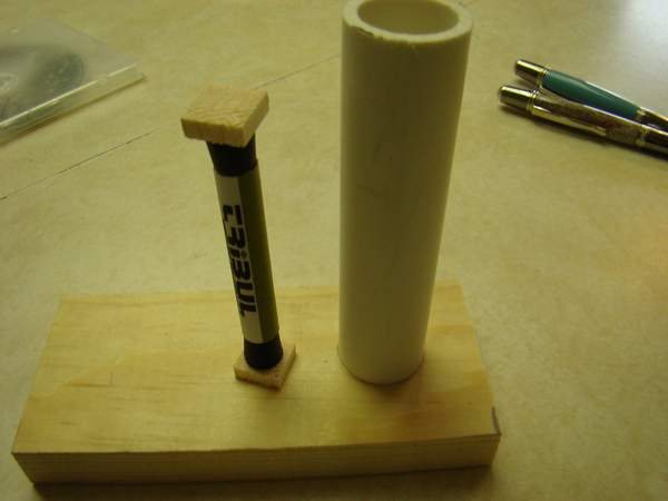

I should probably perfect my casting methods using regular molds before experimenting with something else. I think I had read on IAP before about using PVC tubing, so I thought I would give it a try. 3/4 inch tubing with 5/8 inch square wood pieces on the end of rubber plugs. Unfortunately I dropped the tube on the floor as I was attempting to get the casting out and it cracked. No PR got by the rubber plugs though.
Has anyone done much with this? Will it work, or am I wasting my time?
That is moss in the tube on the right.
