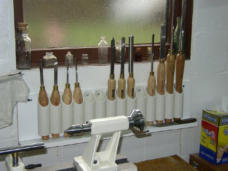

Lee,
I know this is reverse of what you are seeking, but here is mine.
<br />
Bob, that is along the line of what I am thinking of, I am just not sure if I want to try to keep them in one row,or more than one. To be honest, the one row sure looks clean! The thing is that if I make it like yours, I have to replan my entire wall cabinet I have planned. Although, that is not a major problem, I can reclaim the space for other things.
Bob, did you free hand the line up on the pipes or did you have some sort of jig to make them lined up perfectly?
I ain't got a photo but I use a 5 gallon bucket and have it filled with PVC pipes segments in two diameters and keep my tools in it face down. I have to have something portable because I teach, and for about half of my classes I take my tools with me. I keep them face down because it is much safer that way. My problem is I am a scraper lover and have about 15-20 tools that are or will be scrapers. I regrind things like extra skews into scrapers when I need a scraper with a profile I don't alread have. I have gone long past the capacity of my one bucket at this point.
I used an extremely complicated jig... it consisted of laying a 3/4" piece of scrap on top of the shelf lining up all the pipes and screwing them in and then removing the scrap. [:D][;)]
Lee, one more thing that can be done on mine is to add another row on the front in between the exisiting pipes and gluing the new pipe on the 2 sides touching the orginal pipes. This allows room for lotsa growth.
I started out keeping my tools business end up. they are easier to find that way. but I learned the hard way that if you are going to do that. also plan to have them in a place they will not even by accident get ahold of you. I cut my arm pretty bad just reaching for something. even in the picture above the stuff in the window seal gives me the willies. sooner or later your going to reach over all those nice sharp tools to get something. I now go with the tool end down route.
