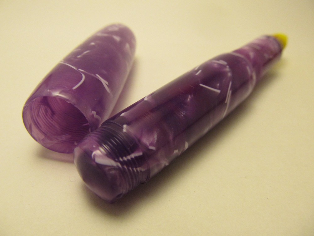

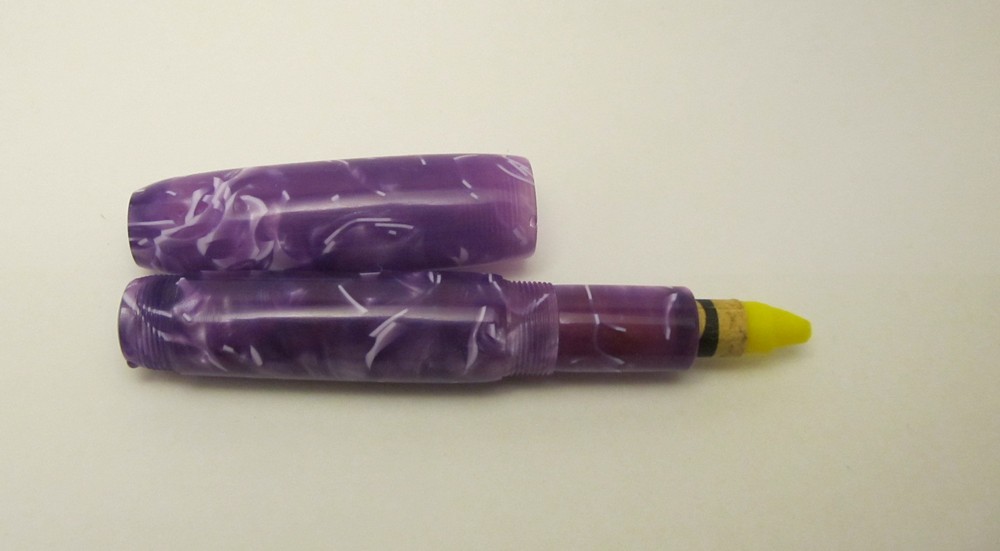

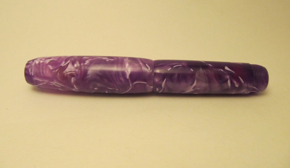

105 – Purple Crayon Holder | newton pens
Made from Purple Webb Acrylic.
Closed 4 1/2 inches – Open without crayon 3 1/4 inches, with crayon about 4 inches -
Posted 6 inches.

You just stuff the crayon in then....no funny mechanical thingy to hold it? Cool, definitely the cha-ching free way to go.
Will too short of a crayon cause 'issues' for removing?

Now that is cool great idea Shawn and as usual great execution on your part. I love it and my grand daughter and grand son would love it. However, I have some questions as to practicality. What happens when the crayon gets shorter than new? How short of a crayon will it take? Is this a cool thing that when used a few times gets set aside or worse yet, thrown away because it is to much trouble for little ones to mess with? Just sayin?

Once the crayon gets too short you put a stub in the barrel to keep the one you're using pushed out. It holds onto crayons with paper better than those without. 8.5mm diameter hole. Without the paper they'd fall right out. I may end up making another section for it to hold paperless crayons tightly as well. :)

What about figuring out a way to have the same thing as the chapstick or lipstick tube has on it, a knurled knob that will push the crayon out as it gets used up?

I was thinking the same thing. Worst case would be to just thread another piece that threads into the baclk of the barrel with a recess to pressure fit the crayon. Then just screw it into the blank from the back to advance the crayon. You could even make a resin locknut. But something that didn't stick out the back, and would still advance the crayon would be better.
