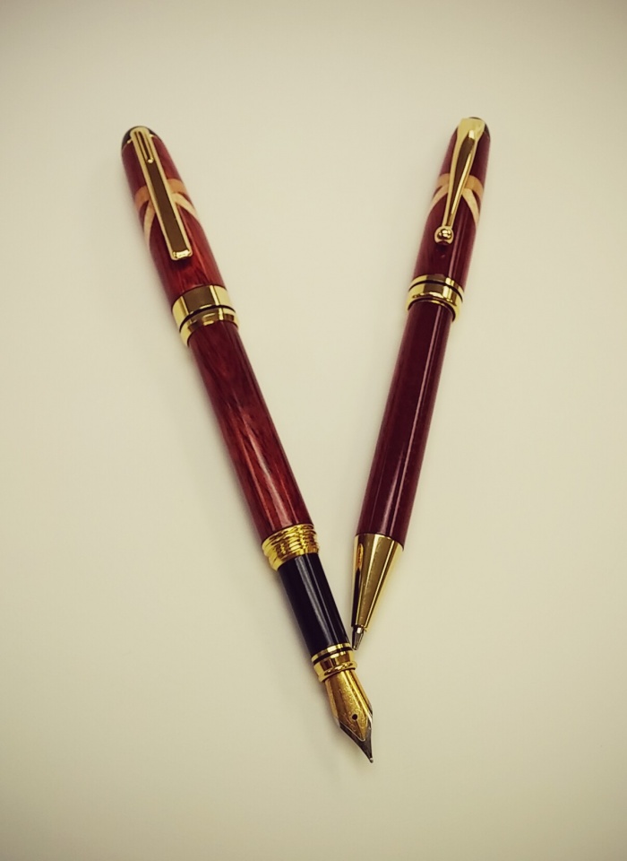

Tell me about it. I made a Fountain pen Pencil set for my son's college graduation. His everyday carry is one of a number of pens he has bought over the years. I was worried that I wasn't getting him a good nib. At least it came with a converter. Also it had a plastic section. :eek:
Turns out he and most people he talks to prefer it over metal. I think he said it makes it too heavy.
I've learned a new language, its been tough because it was a surprise so I could say to him "Hey saw this neat youtube video on how to modify your nib."
