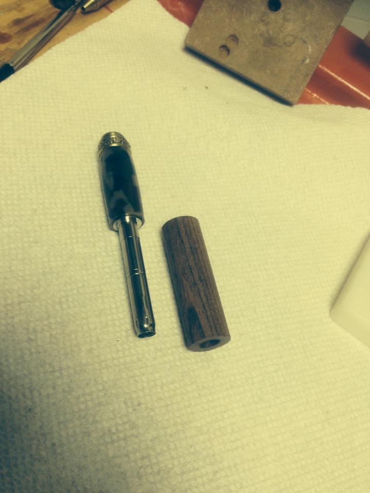

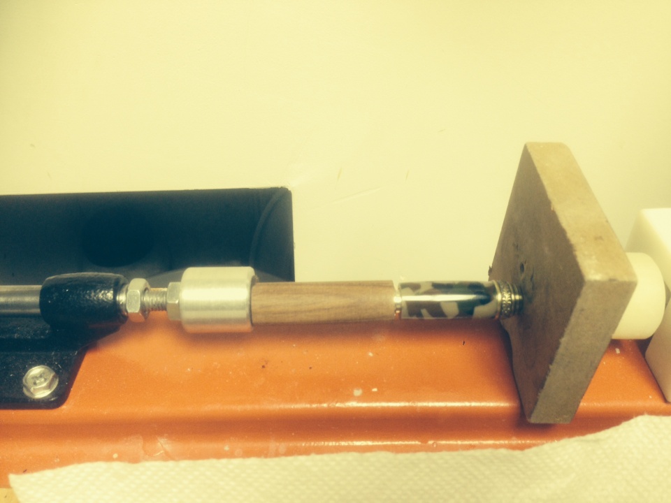

Smitty37;1671715 What I would do in the future is make a jig that would allow me to press the coupler/mechanism in without putting pressure directly on the mechanism....the mechanism is obviously not designed to be pressed in. It looks like a piece of wood with a hole big enough and deepe to pass the mechanism but rest against the shoulder of the coupler would work so the pressure goes to the shoulder of the coupler via the wood rather than the mechanism. [/QUOTE said:
I'm going to try that this AM. Thanks. Frank

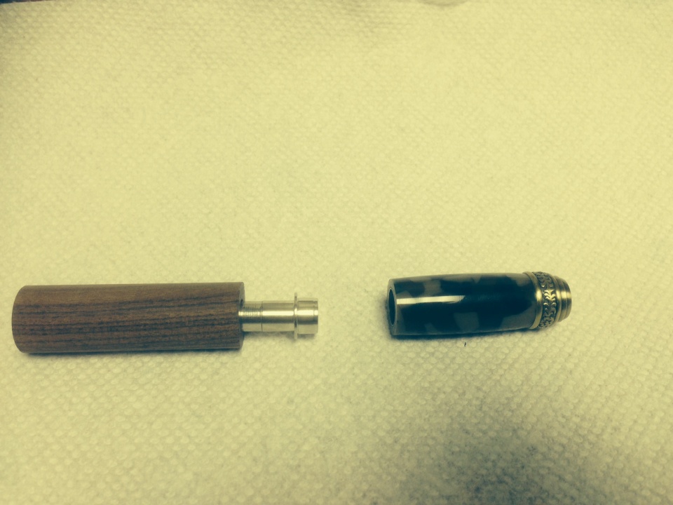

Like a press block? I made some out of acrylic cut-offs... they do come in handy for some kits.
That would be a good name for it. I use one all the time on my click pens.
WriteON
Aug 21, 2013
3,326
Florida & Pa
It worked out great. Thanks for your suggestions. (8mm hole is perfect.)
Also stretched the spring slightly.
