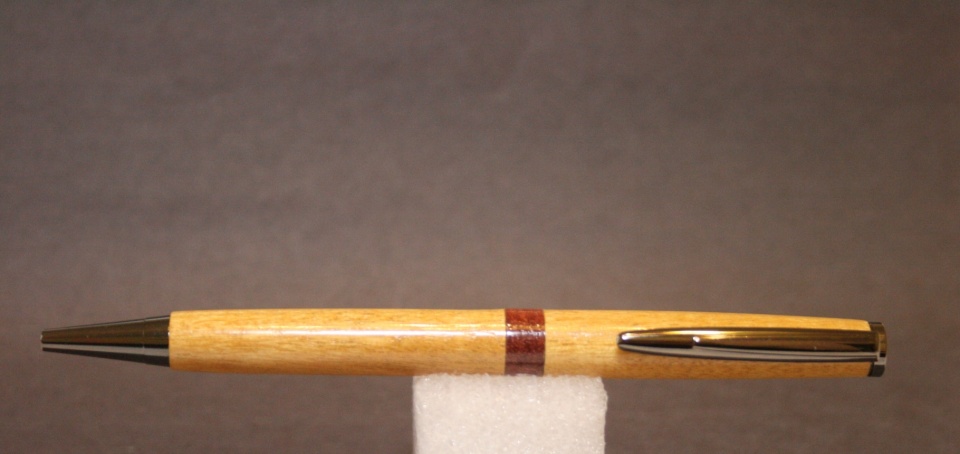

Hello All
A few first with this one. My first trimline pen, the first time I've turned Yellowheart and it maybe the last. I like the look of the wood and how it turns and finishes but I give me a rash were the shaving or dust contact my skin. And the first shot an a custom center band in the case of this pen it Bloodwood. I got the idea of making the center band while turning the Yellowheart and how it would look with a red center band. I thought about Paduck but I did have any scrap, I did have the Bloodwood and I think it a good contrast. The finish is WTF. Any and all comments are welcome.

I like the shape, especially the subtle taper in the upper barrel. I think the bloodwood center band is a good departure from the gun metal band.
I need to take a stab at making some custom center bands. Too many skills to learn, not enough time!

Thanks Brian and Mike for your nice comments. I'm fairly happy with the way it came out.
Interesting variation....actually you could do that with a slimline or a comfort kit as well their cap, tip and tube lengths pretty well match the streamline, so you could get a variation of clips without too much difficulty.

Very nice pen! I really like the contrast of the bloodwood with the yellowheart.
I think I need to try some wooden centerbands.

I think it looks great! Very clean style and fits the clip. Nice fit - did you turn it all together? I originally assumed the bloodwood was glued to the yellowheart.

Thanks for the nice comments I turned the center band after I finished turning and sanding the yellowheart barrels . I used the center bushing and the canter band that came with the kit as a guide to turn and sand it, one it was happy with the size it put the yellowheat barrels and bloodwood center together on the lathe and did my finishing. I really wasn't sure about just how to do it so I took a shot in the dark more or less.

Dan, that is a trial and success. Very nice. I really like the band.
Do you keep a list of the woods that cause you health issues? It would be a good thing to have.

Dan, I Love your selection of Timbers and the Trimline.
Shame you had a reaction to Yellow Heart, as it goes so well with the Bloodwood Centre Band.
Your blank profile is superb, as is your Fit and Finish.
Great suggestions from LeRoy.
You must be very proud and satisfied with your incredible progress.

Thanks everyone for all your great comments. The only wood I have a reaction to so far is yellowheart. I found that out during a scroll saw project. I thought I would give it another go. I am really proud of way my progress has come a long. I'm looking forward to getting my dead and live centers so I can try a TBC pen.
