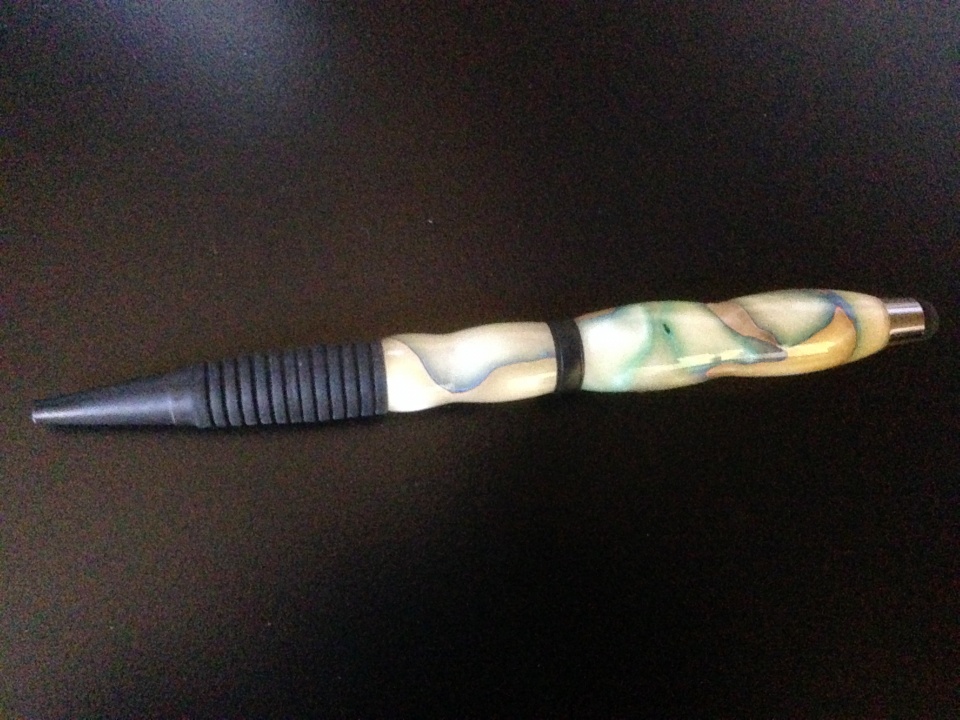

Look awful.... not. And very functional for people with bad hands.

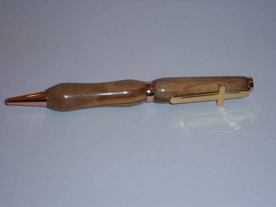

I turn a lot of comfort pens
In the last 5 months I have turned 51 Comfort pens and only used 2 rubber grips, one because the wood split and one because I messed up with the skew chisel and couldn't recover the end of the nib section. To answer your question in detail if you are using the grip then use the comfort bushings on the nib end and center so that the barrel will be "straight" so the large end of the grip fits correctly, if not using the grip then use comfort bushing only in center and standard 7mm (slimline, trimline) bushings on both ends. As for comfort for people with arthritis, I usually turn the lower section with a wide hourglass shape to make it easier for them to hold.

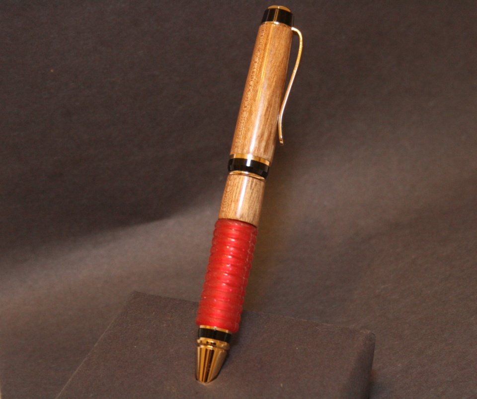

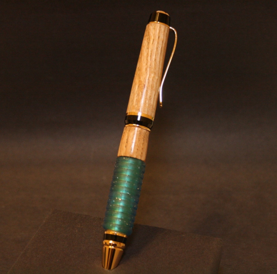

I've had two comfort pen's using a cigar kit and a grip Evelyn picked up the dollar tree. I think they look nice and you have a choose of colors.
