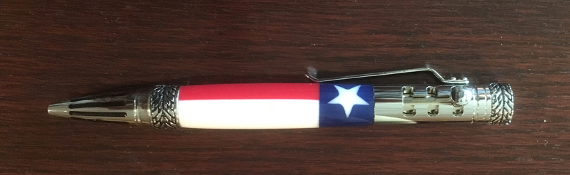

PSI Texas Flag Pen Blank

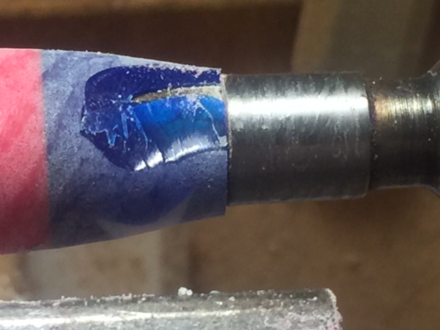

I just attempted my first acrylic pen turning blank, starting with the Texas Flag from PSI. Every time I turned one, I got these funny indentations on the pen blank-I thought it might be my technique or perhaps not turning at a high enough speed. I know believe this is caused by bubbles as this string as reported/discussed. So is this a common issue? Is it also a technique issue? Do all such acrylic pen blanks tend to have this problem. Very curious--thanks in advance.

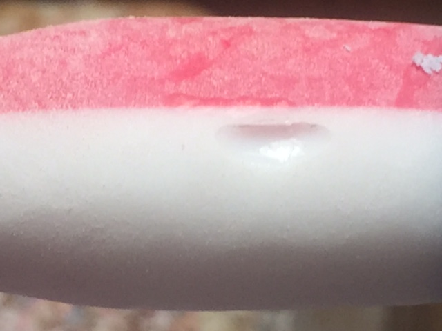

Can you post some close ups. From my experience it can be technique or material. Could be either. I turned 2 of those blanks and got good results. Pursue the project...you'll get the problem worked out.... Let PSI know you're having issues...maybe they will replace them.
WELCOME ABOARD....are you ok in Texas?

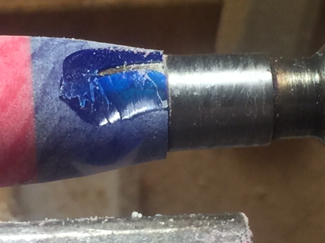

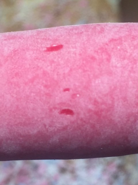

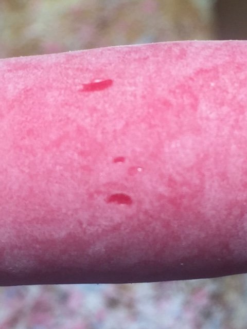

Let us try this again
Tried again with modified technique-higher turning speed (3000) and skew rather than Easytool Ci5 finisher...same issues, although not as bad--
attached
photos for comments and guidance from those more experienced....

Bubbles are usually round. Those are more likely chip-out.
Sorry, need more practice!
Ed
Touch is everything...and patience. When getting toward the finish...be more patient. Move like snail with airbrakes.
OR finalize with sandpaper!! NO ONE sees HOW you do it. With time and practice, you will become more confident and have better tool control.
ONE CAVEAT, if you have vibration in your set-up it will make success MUCH MORE DIFFICULT!!!!! Make sure your tailstock stays snug and use a short mandrel, ONE tube turning at a time.
GOOD LUCK--I once said it was IMPOSSIBLE-(1996ish) --then kept practicing!! Now, it's a "walk in the park".

Yeah those are chip out. I actually wouldn't mind something like that because it is easy to fill with some CA and fix it. Every single one of mine was in the white butting up against the black. I think I did an OK job fixing. I dabbed white paint in and then filled with CA. Was able to hide them under the clips on the two I sold. I made sure to point out the flaws to my customers and reduced the price they agreed to. They both laughed and said I'm too hard on myself.

I had similar issues with this blank. I turn close to diameter and finish sizing with sanding. I even got chip outs using a metal lathe and sturdy tool post with a sharp bit. So no issue with vibration or technique. Sure makes a great pen though.
