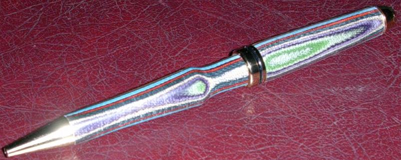

Well I made a pen from this stuff, but it was originally made by me with the purposes of using it for a knife handle. I have since moved away from full tang knives and so I had some of this lying around and it made a very nice looking pen.
This material feels nice, takes a nice shine, is super tough and can be made to basically whatever size/shape/dimension you want (although trimming will be necessary).

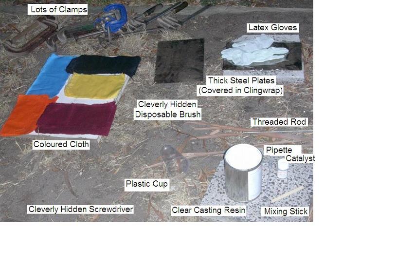

First off get the stuff together as seen below. Notice that I didn't forget to get the screwdriver or paintbrush they are just "cleverly hidden".
When choosing the cloth, remember that it will look permanently wet, so they will be a lot darker than they appear dry. You will also need to have ripped the cloth into rectangles about the same size as your metal plates. This takes a LONG time, do it in front of TV. Also, take the time to calculate how much you will need it is very suprising. Think several square metres... My blanks are about 60 pieces of cotton thick which makes it approx 12-15mm. I wouldn't use anything other than cotton or linen (basically natural materials) as I don't think that I would trust proper bonding with synthetic materials. Also, I know that some people have used things like soaked paper which apparently looks quite nice.
Now, the metal plates, they should be strong enough that they don't bend under a LOT of force - or at least don't bend much. Mine are grip plate about 5-8mm thick. They will stick to your resin if you don't cover them in in sandwich wrap.
The clamps are to jam the whole thing together at the end, but it is best to have them handy.
Put on the gloves as the plastic lives a life of its own - regardless of how careful you are, it will get on your hands and won't come off.
The other stuff is all for the the resin. Use the screwdriver to open the tin and fill a 200ml disposable cup with the clear casting resin. Add 2-3ml of catalyst (using the pipette) and stir with the stick. Pretty tough so far huh?
Now using the disposable brush (as this REALLY destroys brushes) that you have on hand; just like mine .

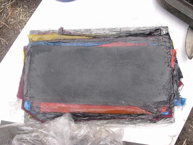

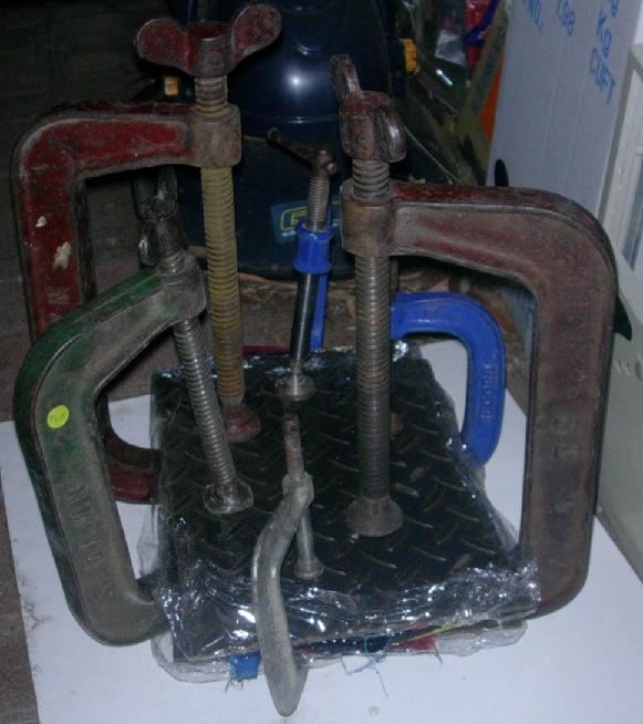

You put the other bit of steel on the top and crush it down with the clamps. Try to do this as evenly as possible, as hard as possible and if you have soaked the material properly, it should spew resin out the sides - so do it over something that you don't care about.
After 24 hours or so, depending on temperature, amount of catalyst and your patience levels you can take the clamps off.
The result will be a heavy block of pseudomicarta (Micarta is a tradename you see). This will need quite a lot of the edge trimmed off, but should be an interesting addition to your repertoire. Remember, if you cut through it you will expose lower layers making for an intersting pattern. Remember that there is no need to be gaudy with this either, you can use dark/dull colours too, but as I said, remember, dark colours will be even darker as they are effectively "wet".

Anyway, this is what it looks like coming out of the mould...

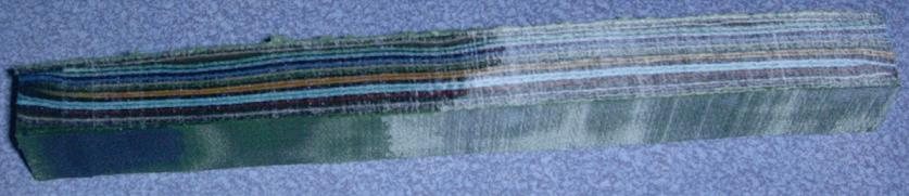

This is what the sawn blank looks like.

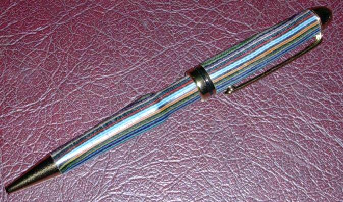

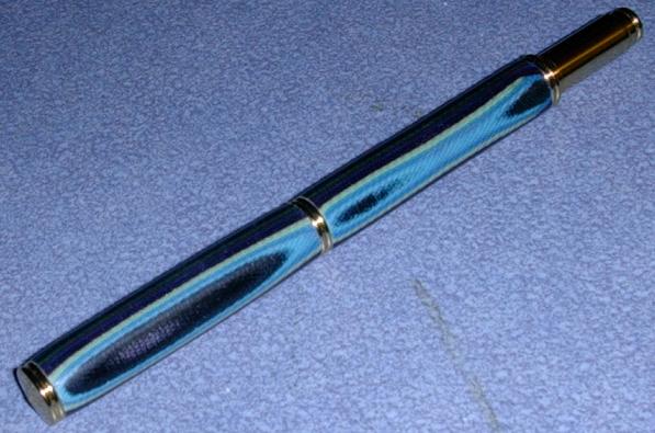

Well finally, here is the proof from the pudding...

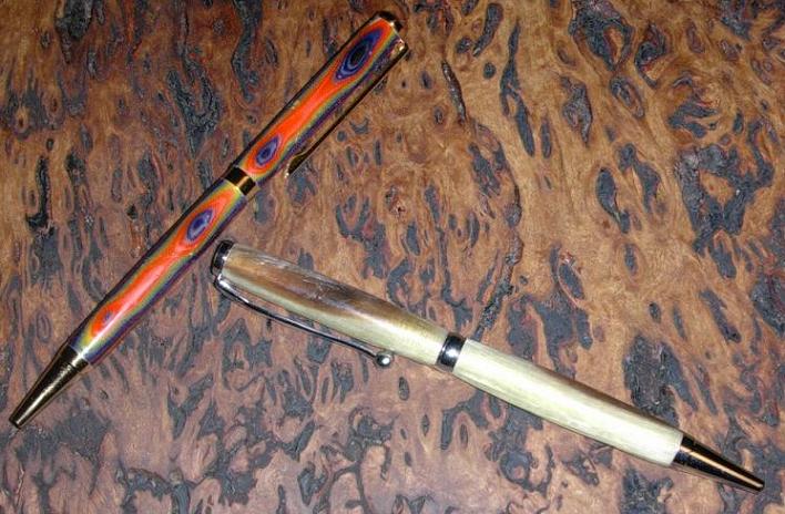

These two shots show the new pen at two angles.
Can I just say again - remember those super sharp scissors that your (insert dressmaker/tailor's name from home) won't let you use. Well, that is because you need sharp tools to cut material, you need sharper tools to cut this!!
Anyway, this pen was finished with wet and dry (used wet) sanding up to 2000, followed by U-Beaut's EEE (of course) and that is all that is required - basically this has a sheen like plastic but feels a bit nicer, well I think so at least.

Here is my latest pen from this stuff... Presently my favourite pen I have made.
<br />
View attachment 200649232947_Pseudomicarta2.jpg<br />
