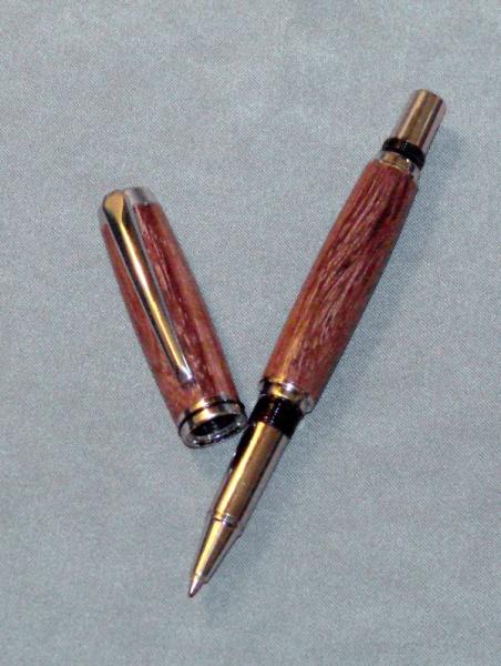

Try Woodturner's Finish from General Finishes. I've used it several times and am starting to really like it. Woodturner's Finish is a hybrid water/oil base poly. The first coat takes a few minutes to dry but additional coats go on much faster. It takes about twice as long as CA. If you wait a few hours it buffs well if desired.
Here's a pic of a pen I finished with it.
Take a road trip. I'm having a rep from General Finishes giving a demo and samples at our meeting on the 29th. :biggrin:
