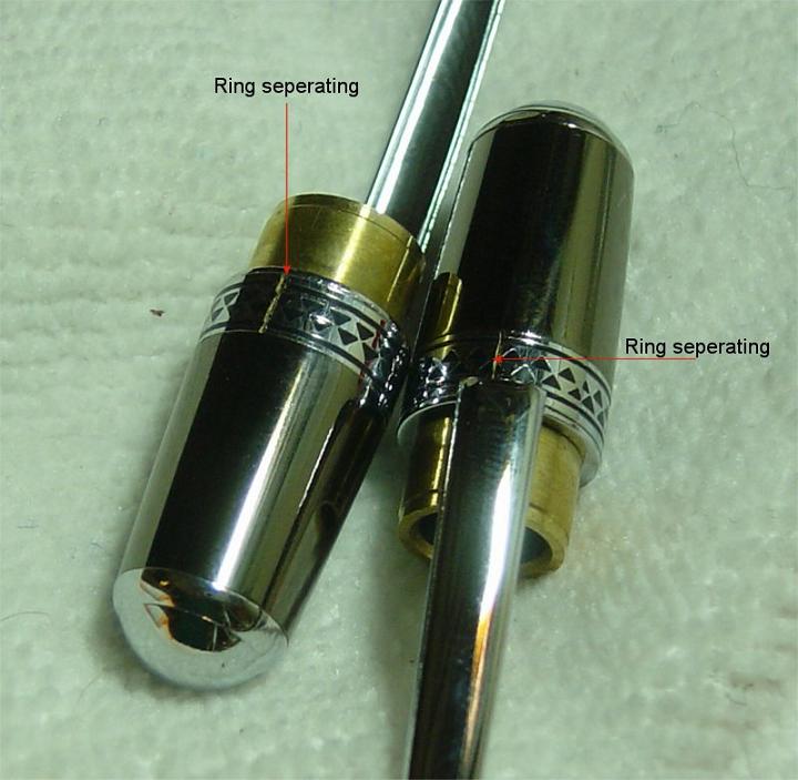

I want to let people know that the top "ring" on one of the Tapas I showed in this thread http://www.penturners.org/forum/topic.asp?TOPIC_ID=22789has come loose. The top ring isn't really a ring; it is two pieces. When I get home I am going to try to CA it back on.
Here is where the ring came loose:

Thanks. I was also thinking the same thing through the day. I can't decide if I want to go epoxy or loctite. Any suggestions?

I would first contact who you bought it from. I might try some epoxy first. The CA may not be a problem since you are leaving it out in the open and not covered up. Let us know how it turns out.

Update: I have found two chorome failures (so far). It looks like the gold may be alright.
I tried to glue the ring back on, but I can not get it to go all the way around. I suspect that they milled the brass insert a thousandth or so big and forced the ring on. Give it a bit of time and it fails. I am going to try contacting WPP to see what they will do for me.

Scott, if you need any help, let me know since I did the bulk purchase of these. I have made two Tapa pens so far and the ring came loose on one, but after I assembled it, I have had no problems. I am still trying to get enough use to see if the black chrome comes off like reported by a few others.

Jimmy from WPP got back to me with a prompt response. He is working with me to get the problem resolved. I will give another update with the final outcome.

Wow, did it break, or is that just glare from something? I only had one where the ring came loose, but none so far where it broke.[:0]
