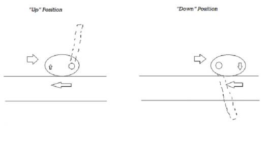

I Figured out how to fix mine!!! It is very simple!!! Instead of tightening the handle in the "up" orientation, you just take it to the "bottom" and tighten it, it is based on the principals that the bar that tightens onto the Lathe frame is tensioned via pressure against the frame, and when you are in the up position, the egg shapes bar is facing the headstock, so when you tighten the tail stock , it unsets from the frame, when it is in the down position, it is facing away, so when you tighten the tail stock, it just makes it tighter... Check out the attachment... (sorry about the size)

Instead of tightening the handle in the "up" orientation, you just take it to the "bottom" and tighten it.
I envy your success. I've already tried that on my Rikon. While tightening it down was a slight improvement over tightening it up, it was still not good enough. Either way, I could tighten the clamp as hard as I could, yet it would loosen with a slight touch of the finger on the handle. Heck, it would loosen with a slight vibration and gravity, harsh words or a disapproving glance.
I've ordered a square clamp nut from johnnycnc. It seems a lot of people have had success with that. I hope I won't have to envy their success as well.
