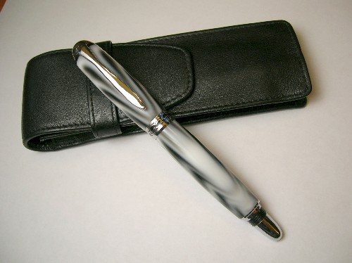

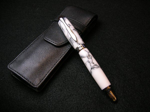

Here are two I kept for my own use and I give them a thumbs-way-up.
