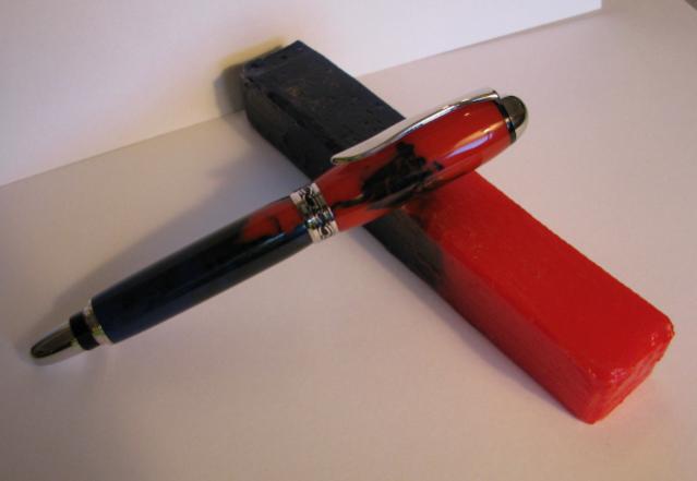

I had a custom order for a KU colored pen.
I used Mixol tints and used a thick paper in middle to seperate colors. the pulled out paper and then did some swirling with a toothpick.

that is awesome...very different...how long did you have to wait before you pulled the paper our of the resin...still have yet to cast anything, but got all the stuff for it. :)

I poured in the two colors at the same time and then when the resin is at the top of my mold i pulled the paper out. So I didnt wait for a gel or anything like that.
