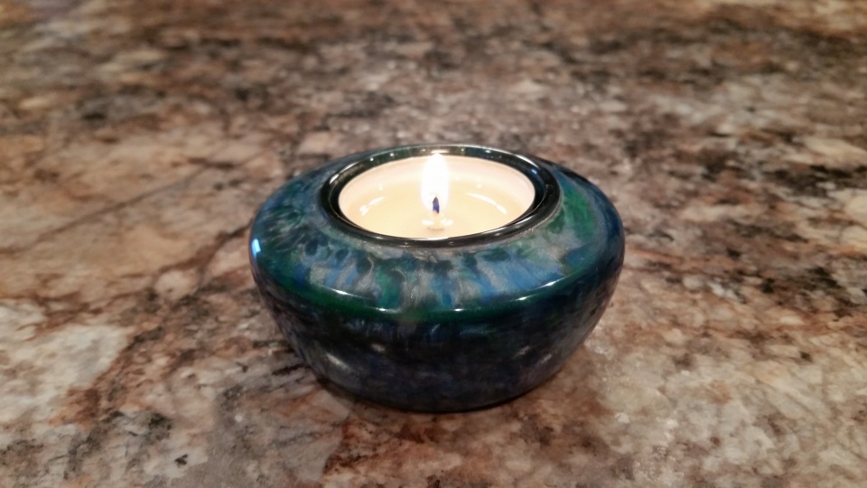

PR candle holders?
See more from KCW
KCW
Dec 18, 2014
382
Lincoln, NE
No one? Well I tried it, and looks ok. I lit a candle in it last night, and it didn't get hot, so that is a good thing. I would change a few things, but I'm pretty happy with it.

I think that looks great! Beautiful coloring and a nice shine too!
Did you reverse chuck it from the hole to turn the bottom?
I wish I had a chuck to do it that way (would have been much easier). I had to rig up some interesting stuff out of wood to turn this thing.
It is good that you could figure out a way to hold it. When one stops and thinks, usually there is another way of doing the same thing!

I like your candle holder very much !! Did you cast the resin or use a bought piece ? Also, it looks like the candle is in a glass "dish". Right? What is the approx diameter of the candle and "dish" ?
I am going to try making something similar but not very familiar with the size of tea candles right now.
Thanks
Thanks, I cast it myself. It does have a glass dish in the center, from CSUSA. I think they are around 2".

I'm not positive of cured PR, but the liquid is very flammable. A candle burning inside a flammable holder may not be the best idea. I'd try a small piece of PR to see if it burns easily before using these. And especially before selling any.
Probably a good idea Bob. I was concerned at first about the same thing, but since the glass is cast into the PR as a barrier and the heat did not transfer into the PR, that I could tell, I was set at ease a little bit. I also thought, wood is flammable too, and people are always making candle holders out of that.:biggrin: I think I will take your advise and test a small piece of cured PR to make sure.
