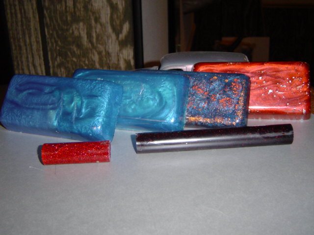

Here are some PR blanks I made over the last 2 weekends. The blocks I used pearls and the rods I used different color flakes and PR dyes to color them.

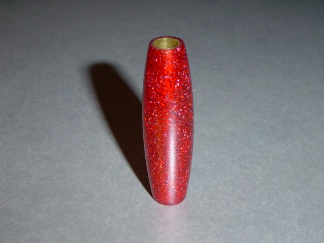

The flake is called jewel glitter. It is for stamping and can also be used on fabric art. They are avaliable from michaels. The molds I used to make them is just 3/4" pvc pipe just put a cap on the end. This is a piece I turned over the weekend for a slimline.
