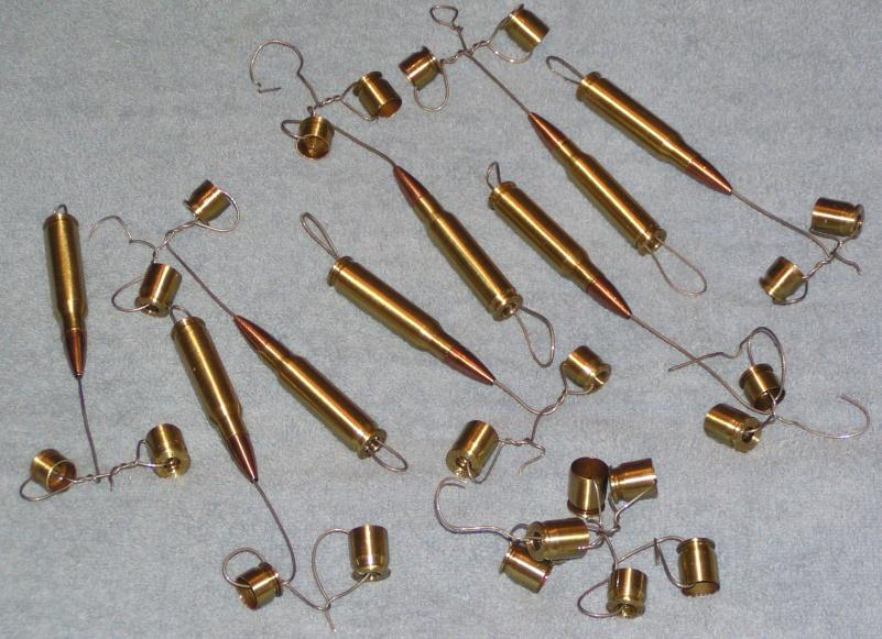

Well I finally got the powder coating done. The tubes are soldered in and all is ready for me to decide what to use for the top half. I have used antler before, but now I'd like to try something different, maybe clear cast some snake skin! what do you think?

Here's a trick you might want to try next time........
I install the transmission BEFORE I powder coat, that way there's no chance of ruining the finish while pressing it in. What I did was buy some heat resistant tape, 1/4", you can get it at any powder coating supplier. I install the transmission and then wrap it with the tape before I coat it, it works great and I've done over 100 and so far no problems with the heat ruining the transmission.

Looks like the clear powder coating has discolored the brass and copper which is what I found. That's why I like to coats with lacquer to avoid the powder coating discoloration.

Polish the brass and buff to a nice shine.
Wipe off any finger prints, oils or buffing residue just prior to coating. I use alcohol and handle with nitrle gloves.
Temperature can be too hot or the pieces can be too close to the heating elements, especially in small toaster ovens.
There is a lacquer for brass. I saw it in a Craft Supplies catalog awhile back.

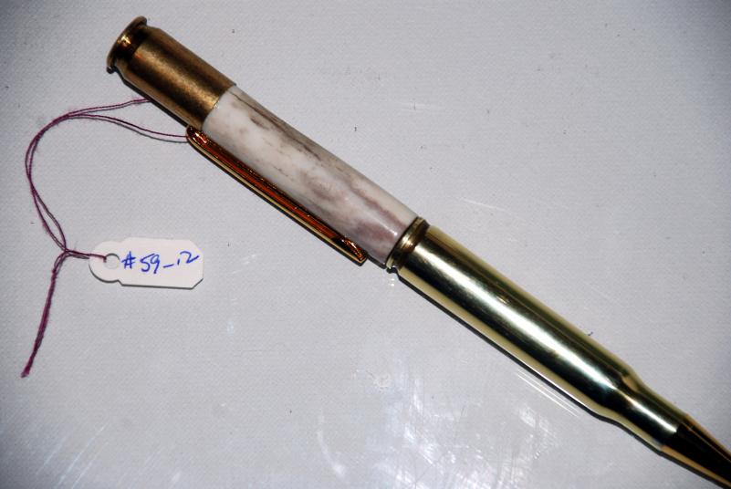

Just finished a bunch of these. No comment. The powder coating did turn out the way I wanted. I think it was a heat issue. Pens - 4-13-12 #59-12 .30-06 Antler .45 Polished 4.jpg
