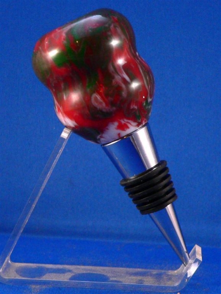

As said, not hard at all. This was left overs from some pen blanks I was making. Just left the excess in my mixing cup.
