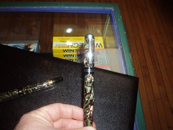

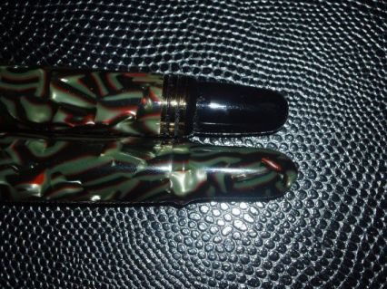

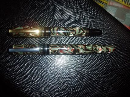

here are a few pictures. sorry about the quality but i'm at work with a hand held camera and no lighting. This one shows the cap posted.

Interesting soloution, thanks for posting your photos showing your posting end treatment.

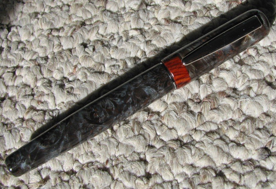

An EG I made postable (sorry for the poor photo quality on this one it was just a quick and dirty photo before the pen went out the door).
http://www.penturners.org/oldalbums/bjackman/blue maple sm.jpg

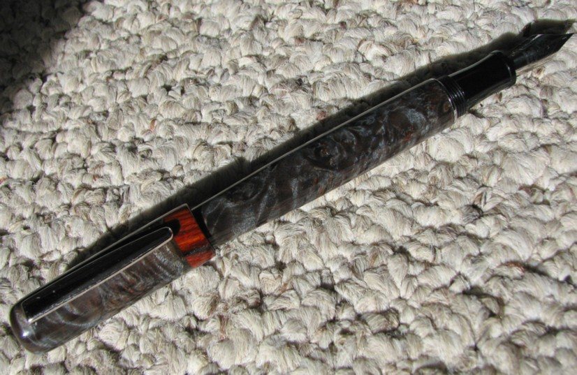

And this is it posted:
http://www.penturners.org/oldalbums/bjackman/blue maple posted xsm.jpg

I think your design and choice of materials are a good choice to help minimize signs of posting and contain it in a spot that makes it look like it was made for it.
