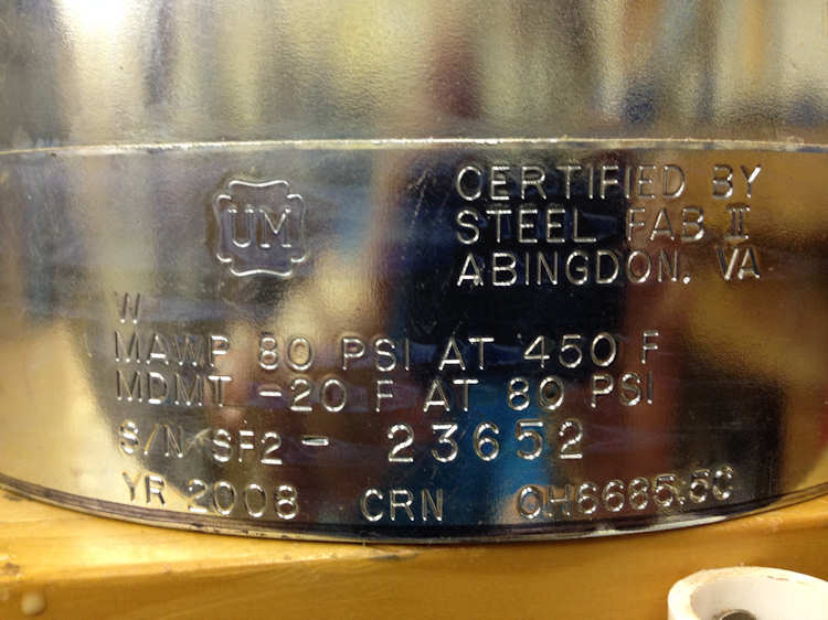

Here is a picture of the certification stamp on one of my pots to back up what I am saying:
attachment.php

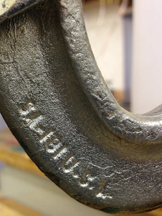

And here is a picture of one of the clamps with USA cast into it:
attachment.php
I did not find a made in USA stamp on the pot itself but I do remember reading it in the literature that was in the pot when I got it. Besides, when new, it did not smell like cosmoline so I am sure it came from the US! :)

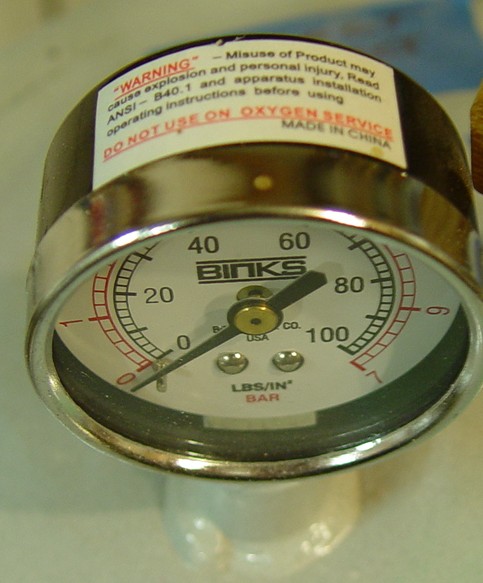

Hmm, I think that the quality of the Binks tanks must be in decline. For starters they use at least one Chinese part; the pressure gauge. So being a Chinese part "that can't be trusted" (maybe it's reading 80 psi but it really is more or less?) Needless to say, I took the gauge off my Binks and put it on my old HF pot. If you look the pic you will see the Binks brand in the gauge dial and a "Made in China" sticker on the top of the gauge. I also looked for any "Made in USA" stamps on the binks pot itself and found none, although the clamps are stamped with "USA". I also weighed the lid on my binks and it weighed 6.8 LBS, my HF pot weighs 16.8 lbs, that is 10 lbs more than the binks lid. To compare I weighed the lid on my 15 Gallon binks which is much larger than the 2.5 gallon Binks and it weighed 18.4 pounds...just 1.6 pounds more that the entire HF pot. So is binks now using cheaper/lighter steel...maybe Chinese steel?
Not too worried about my gauge blowing up! Mine have different gauges than what you show in your picture. Mine do not have the made in China on the sticker. However, after purchasing over 1,000 vacuum gauges and being very familiar with gauge construction and quality, I would guess the gauges on my pot came from China too. Regardless, this does not surprise or concern me. Binks makes pressure pots, not gauges and again, I am not too worried about my gauge blowing up!
