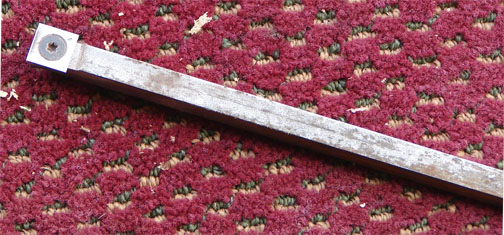

As always, I fear that if I open my pocketbook, the seams will crack. So, after seeing the glowing reports of the performance of the C1a tool, I figured I could make one, or several, at much less than the C-note price of the glamor model.
I bought some spiral planer blade cutters at about $2.50 each, screws at $1.00 each and some one foot long pieces of 3/8" square cold rolled steel at less than $3.00 each. Total cost $6.50, sans handle. And that will come out of the "I can make something from this" pile of cut-offs.
As reported, it hogs wood off like crazy. Two caveats: tosses chips like crazy also. Wear eye protection. Be careful touching the cutting edges, very sharp.

Thanks all for the positive responses. I'll cover a couple questions in one post.
The cutters and screws came from Grizzly. The cutters are 14mm. They also have 15mm at about double the price. But, I figured that even the smaller size removes so much wood so freakin' fast that not much was to be gained by using the larger.
The steel was bought from a local steel supply/fabricating company. Actually almost any hunk or rod of steel could be made to work with a little grinding wheel time.
Drilling was not a problem. But, since I used cold rolled steel, very tough stuff, tapping did take time and care. I'm questioning whether hot (mild) steel might be a better choice just for ease of working with it.
I have no plans to sell. This is too simple a project and I don't believe there would be much of a market. I'm not a real handy guy, if I can do this, anyone can.

Do you by chance......have the Grizzly part number for the cutter and screws that you purchased? Been looking for awhile on their site and all I can come up with is the H7354 Shelix Replacement Tips, 10pk @ $29.95. Do they list/have other sizes and/or shapes? No mention of size (14 or 15mm) on the tips I did find or location of the screws you used.
THANKS......
The tips I bought are: H7319 @ $24.95
The screws are: PFH35M flat hd torx R20 M6-1 x 15 @ $1.00 ea.
This info from my receipt.

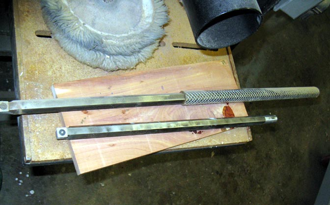

Heck I have been using these for the last 6 months---a freind made them for me ---all I supplied was the cutters---the long one is for bowls and the short for pens---notice the high tech plastic tube handle on the long one---that came from BORG---cost for building both of these---less than $20.00
Way to go. I never claimed to be original. Just cheap.

Heck Frank--- in my case it's just a matter of being poor. I can't find the link but there was a place you could buy the cutter cheap--- If I find it I will post the link. I bought them as router replacement cutters?????
