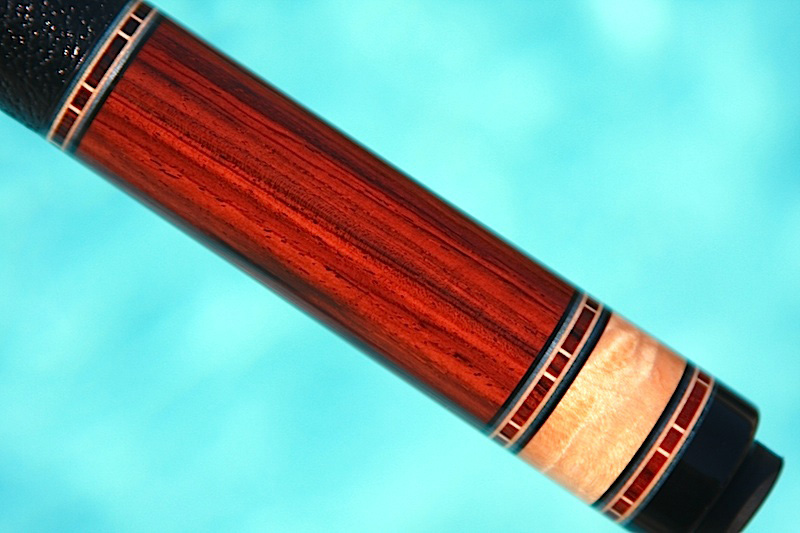

Any ideas how I might make rings something like these? This is actually what got me interested in pen turning. I own a beautiful Southwest Cue, Jerry Franklin era, Purple Heart and Ebony. I always wanted to make a pen to match.
It's called segmenting.

I should have said originally, I know it's segmenting. I've already started doing some simple segments but have no idea how to do something this 'complex.'

Well it really is all the same, but as you said more complex but if you think about it on a larger scale to start with and then just scale it all down. So like those rings you can put it altogether turn it round and then cut the rings off the size you want them and then sand and glue them where necessary.

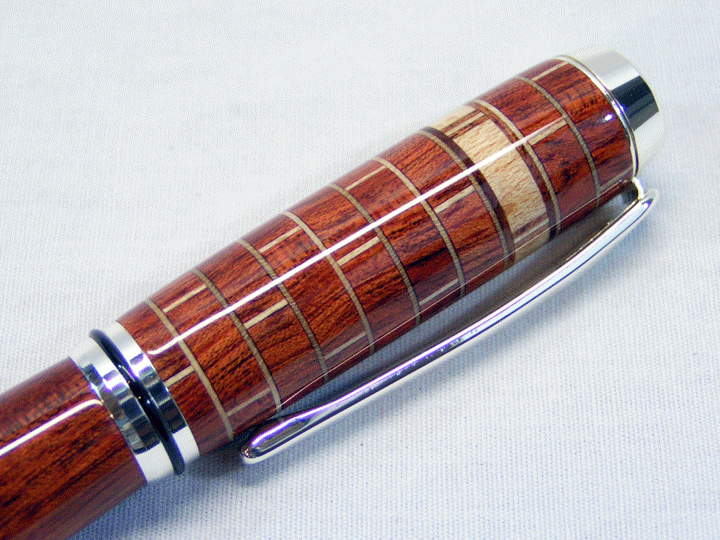

Here is a harlequin pen I did a while back, may give you some ideas on little squares, lines are simple inlay slices. This one was one of my first and that that accurate, but you get the idea.
Hope this works, the photos are from another forum.
Cheers

Here's a segmented one I did that has some of what you are looking for. It was pretty easy.
