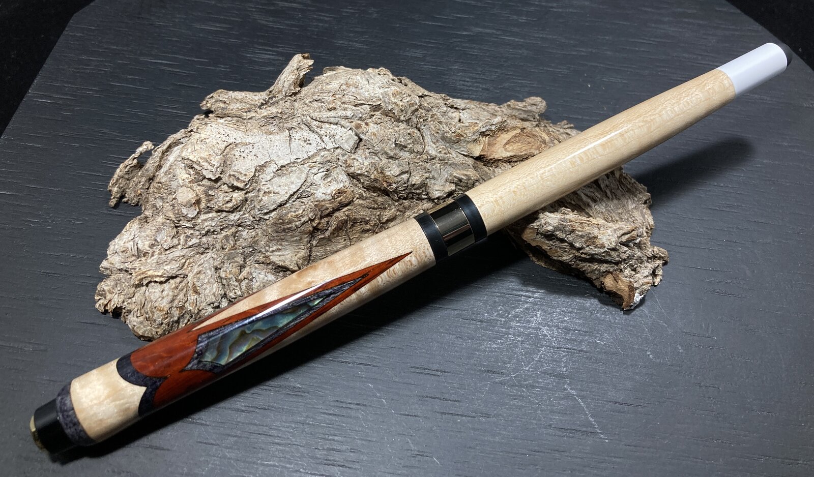

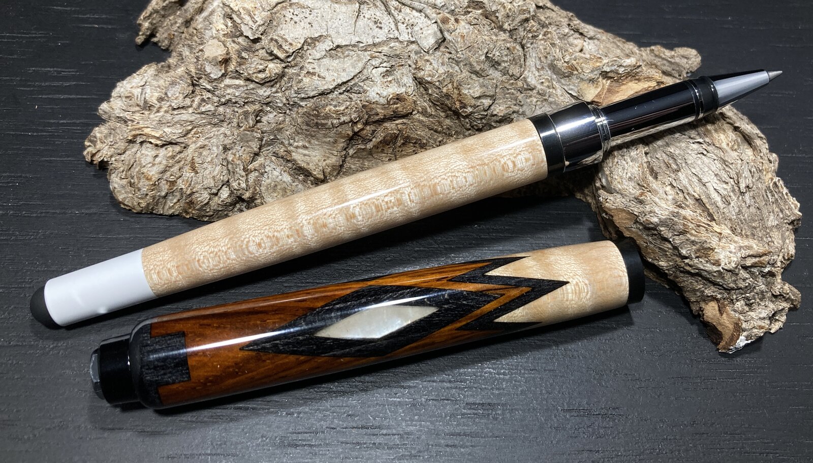

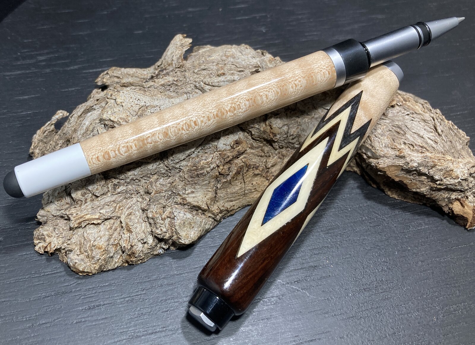

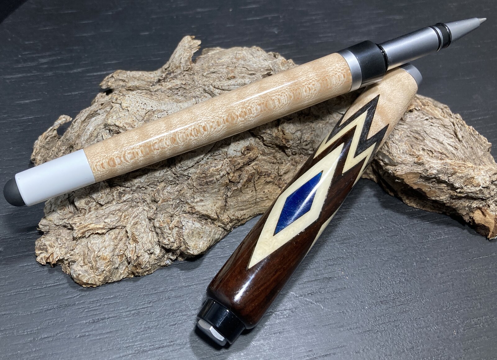

Hi John, I have made a couple of these pens, and you are correct - the slider bushing is for forming the "Butt" of the "Cue". I was also confused with some of the instructions at first, but lining up the parts and bushings, it became clearer how it's supposed to work.
My biggest concern when I started was fitting all the pieces together and keeping them together. The instructions recommend trying different pieces in different spots until you have a good fit (i.e. some laser cut diamond shapes fit into different laser cut channels better than other channels. Also, try rotating the diamonds 180 degrees (top to bottom, not front to back) and see if the fit is better).
Once you have the pieces assembled the way you like them, definitely use all of the little rubber bands to hold everything in place. Then douse the whole assembly in CA to lock the pieces in. Don't worry about the rubber bands, they will come off during turning. Also, don't worry too much about some gaps between pieces. When you sand, the gaps should fill in.
I have attached a couple photos of pens I completed.
I wouldn't worry too much about forming the Butt of the cue perfectly. You just break the corner of the wood and round it a bit with your gouge or sandpaper.
Hope this helps.
