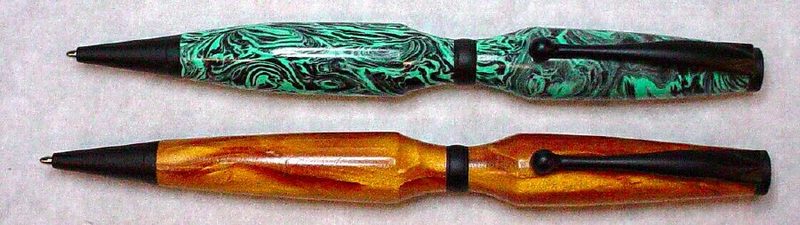

I've done several clay pens, but I don't wrap the tubes. I make blanks by rolling the clay into a sausage shape, then baking it. Then I simply drill it as I would with any other material. So far, I've had no blowouts and I've had no problems gluing the tubes in with 5 minute epoxy.
