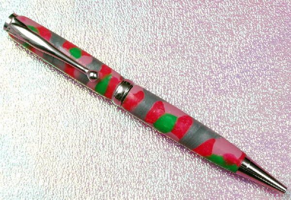

I have been working on polmer clay.
Very interesting, comments welcome

Nice designs, I played with it several years ago. Could never get the shine I wanted on the pen
and there was an issue of durability of the material holding up to the daily use.

Nice pens. I like the last two best. I've been doing quite a few polymer clay pens. I made four of them about 6 months ago and gave them away as test pens. Two of the people hang the pens on a lanyard around their neck that holds our ID badges. The plating has begun to wear off those two pens, but the clay has held up fine. I used a CA finish on them and it looks just as good now as it did when I finished them. My biggest problem is the clay flaking as I turn them. I've been thinking about cooking big blocks of the clay and then trying to drill them. As it is now I've been wrapping the tubes.
Good looking pens. I kind of look at polymer clay as the poor man's resin casting.
