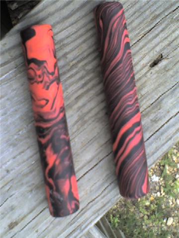

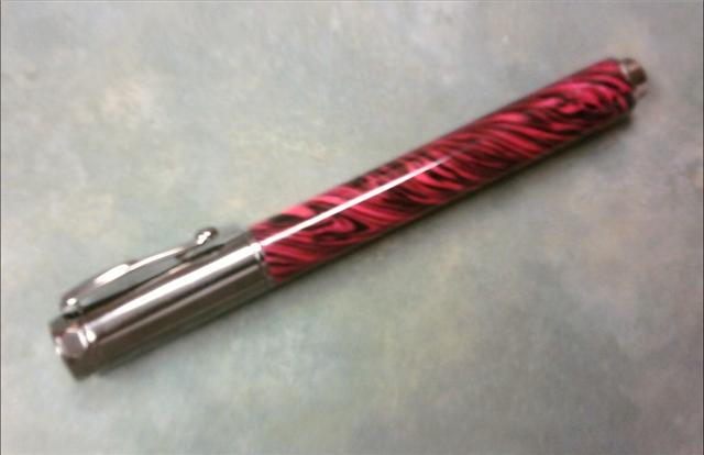

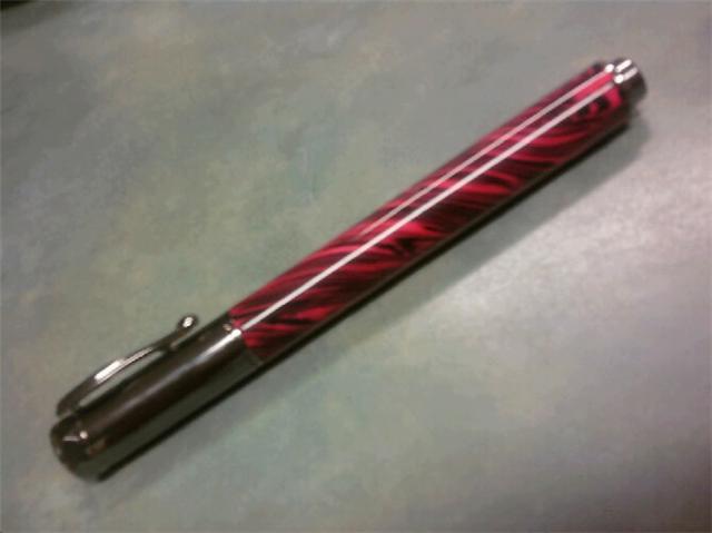

A few weeks ago my wife went out and got me some Skulpey PC at Hobby Lobby. Toni was kind enough to let me know that Skulpey was a PIA to work with, so since I didnt have the reciept I decided to use it anyway and try making a blank from it last weekend.

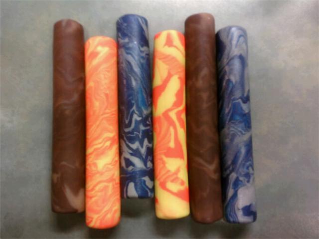

Kneaded the clays and crushed the two colors together and made a blank a little under 3/4x5. I noticed the "kneading" of the clay is important to help soften it up and make it meld together. The "Polymer Burl" was baked in the toaster oven(as per instructions on the side of the PC wrapper)and let cool. The blank came out of the oven a little soft, I could put my fingernail into it and pull out a small piece, but after it cooled for a while it got a little harder, I could still put my fingernail in it but had a smaller piece chip off. Im not sure if that normal or not , I have never worked with the clay before so I wasnt sure what to expect.
I got a little excited with the results and decided to start processing it like a regular blank Within about 4-5 hours. Drilled, tubed with Sumo glue and mounted on the lathe.
My PC Blank turned like dry butter, a little powdery but very easy to cut. At some point during the cutting I started to get long ribbons of the PC untill I came to my final dimensions. Wasnt sure how it would hold up as a pen, It was still a little soft after the fingernail test, but it was a bit harder than what I started with. I figuered I would use it as a show piece at the house and let my wife use it at her desk to see how it would hold up. Used 4 coats of med CA to stiffen it up some, sanded, polished, and put it together. After the CA it was very hard, no fingernail abuse anymore, and feels as solid as one of my wood pens.

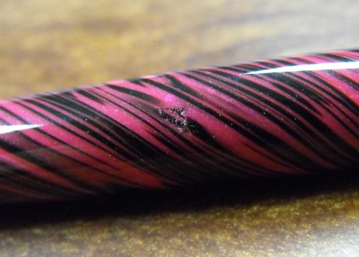

Should have let it cool over night because I did notice that there were small cracks in the PC under closer inspection and as I turned I did have small areas that didnt stick to each other and got some chiping. The chipping, I think its from the kneading of the clay(could have probably used more) and the small cracks that looked like they were on the inside seem to be from my drill bit either not being sharp enough or me being too agresive during the drilling. Other than that. I like the way it came out. I like it so much I got more clay and made some more PC burl blanks.
I figure Id do this till I get the hang of the clay before I try what Toni is doing. I know its a waste of clay but Im comfortable working with blanks, I know how to work it from there.:cool:
Sorry for the cruddy pics, Camera phone shots. I will try to take better pics later.

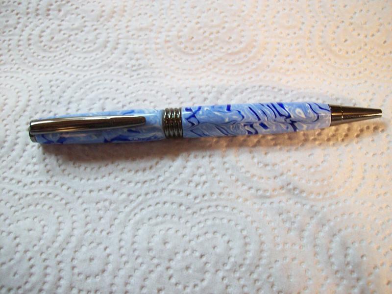

Guys do not fret over the seam. Here is my first PC pen. It is wrapped and you are looking directly at the seam. The PC pens I've made since the seam is even less conspicuous than this.

Oh Lupe Mi Amigo not you too!! We are falling under the spell of this enchantress, But it's a pretty neat looking pen, I wonder if this is the same reaction that happened when pen turners started messing with Acrylics and PR?? HUUUUM

Yep, it depends on how much of a pattern there is. I've done a couple Faux Makume Gane that look nice, but the seam stands out in the overall scheme. Not bad, but I want better (myself being my worse critic).

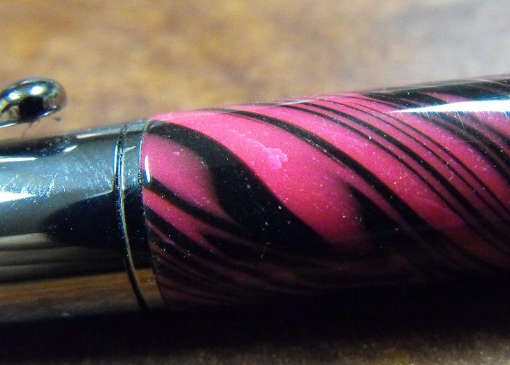

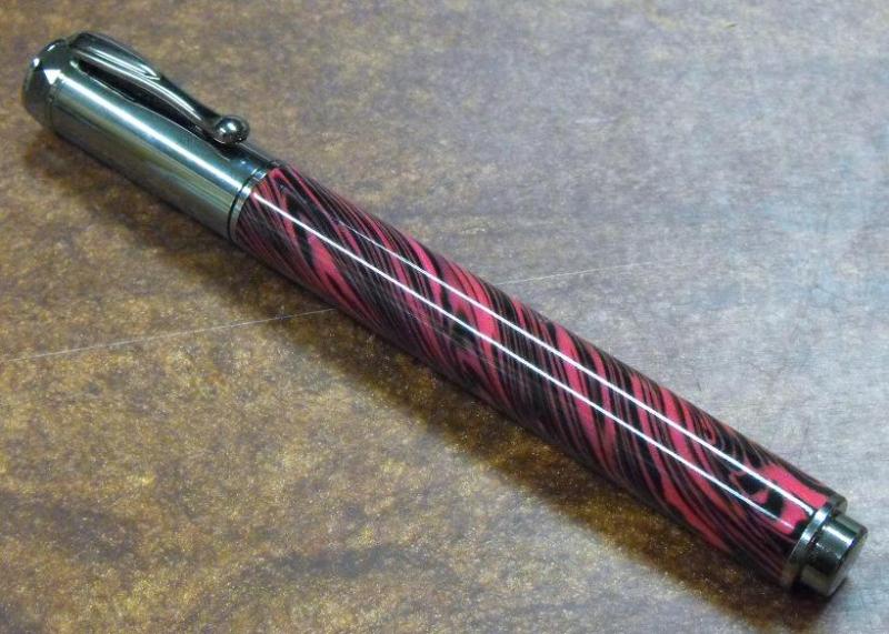

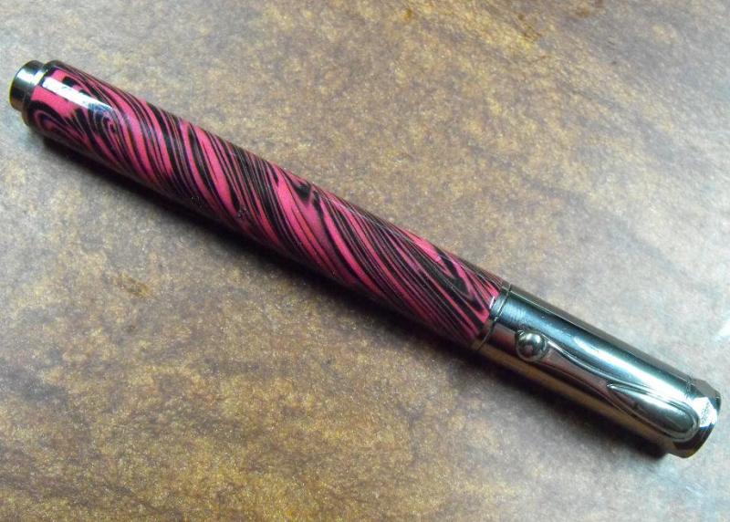

Here are better pics of the ZEN.

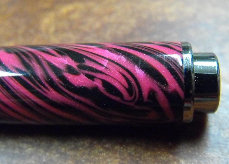

And the cracks, and rip outs.

Sorry Dean, Is Cyberspace not big enough for 2 Vaders?
I like it Rusty, Maybe I can alighn the seam before I swirl it and make the pattern.......
Sorry Ken, What ever attracts the ladies WHOOO!! (walks away strutting like Rick Flair)

Nice pics on the pen... If that was your first tries (and Toni says with the wrong materials.... ) I'll bet they will be GREAT in no time. And if you hadn't given us extreme close ups, we wouldn't have known. :ghost:

Welcome to the dark side. It is best to let it set for a day or so once baked. I have even noticed with the pens I make the clay continues to stiffen over time. I have some barrel I made about a year ago that are rock hard and much harder then anything coming out of the oven now.
The key to turning it is super sharp tools and light cuts. If you get to aggressive it will chip in a second. I try to get close to dimensions by turning and then switch to sanding. If you wet/dry with 220 dry wall screens (they don't gum up) you can remove alot of material...and fast. Then switch to more standard sanding methods.
Good luck and next time switch to Premo, Kato, or Pardo. Sculpy is the softest and most tempermental of all!
