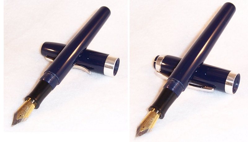

Last week I took a lesson in using PMC and tried a clip which turned out to not be strong enough and was a big let down.
But centerbands... that's another story! :)
Today I made and fired a PMC silver centerband for a new pen I'm working on and it turned out great (at least in my opinion)!
Here 'tis, at noon today that center band was just a wad of clay!

Very very nice. You have come up with many solutions. The PMC CB turned out great. Have you given any more thought about the clip?
It seems to be the last piece to your puzzle.
On the pen shown, What clip have you used?
Thanks for sharing this with us.

Right now I haven't given any more thought to clips. For the time being I've got several hundred kits of all types and I'm perfectly content with robbing clips from the kits.
This clip is from an Atlas pen and when you think of it, catching this kit on sale for $3.50 or so isn't a bad price for a clip! :D

What part of the cap contacts the pen body when posted? One of the things I noticed yesterday at the pen shop was that on many of the pens I examined. The threads were not what contacted the body but they had a step drilled cap as we talked about the other day. So the second step is what was in contact with the body. Hope thats clear? That way the threads were not being stressed when the cap was posted.
My cap only slides over the lower body abot 3/4" and the first step is farther back than that so I'm resting on the threads... barely!

Wow! Great work. Since a read a blurb awhile back on the PMC silver, I've been researching and gathering my pennies for my own kiln.
Sorry for being a little late to the game, but it appears that you cut your own threads on the pen body. Have you shared how you did this. I go hunting thru the archives if you've already shared that. If not, wanna clue me in on how you did it?
Travis, I just got into using the PMC and to date have only spent around $200 on supplies which includes a good bit of clay. I too thought I would have to buy a $500 - $700 kiln but so far have made all my parts using the PMC3, placing it on a brick and firing it with a mini torch.
It takes about 5 - 7 minutes and the torch cost me $20 and the small butane bottles cost $2. I fired four pieces on one charge of butane which probably used a third of the can meaning this is a dirt cheap method compared to the cost of a kiln.
As far as instructions, there aren't any, just that I used a tap and die. Pretty straight forward but you do need to work out which size bits to use to match the style of pen you want to make. There was a recent group buy in the group buy forum where these items were discussed quite a bit.

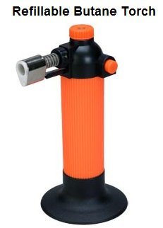

You say you use a butane torch. Does it generate sufficient heat? My understanding is that you need a hotter flame than what butane creates. Are you use MAPP gas (green bottle)? Thanks on the tap-n-die info. Boy, you go away for a couple of months to work, when you come back you sure miss a lot. Still doing catch-up.
Texatdurango,
I found a small kiln for around $150. That's what I shooting for. Just got to get it past the budget committee :D.
Travis, Every PMC supply site I visited sells the butane torches, I used one in my first PMC class, I bought one and have fired several items so far including the two centerbands below and have yet to deplete one $2.00 can of butane! I think I would talk to someone about $20 torches other than someone who is trying to sell you a kiln!
Here is a torch similar to mine, and yes they can get hot enough! The silver glows bright orange after about 40 seconds and it takes about 6 minutes to fire a centerband.

I like the centerband, but it lacks any flare. It needs a groove in it. You could cut a groove and fill the groove with epoxy or inlace.
My clip idea would be to take the clip you desire and grind the loop off it. Spin a piece of wood that will be the end of the cap, lets just call it 1/2 long. Cut a piece of wood 3/8 long, just a hair shorter and shape it to fit on the side of the cap piece. It should be thin like a toothpick. Glue your clip piece to this toothpick like piece. Now cast this assembly into your molding clay stuff. The idea is that the clip has a 3/8 length of attachment that will give it more strength for the up pull of a shirt pocket. a typical metal clip has far less, but this isn't typical metal. I like the idea of adding "rebar" as well. Metal may not be necessary, just a piece of no wax dental floss, something like that which would be the fiberglass stranding in your concrete.
I hope you follow that. Is it a good idea, I don't know, that's for you to play with. It's a similar idea to the guy that makes the wooden clips on his big wood pens, only you would be making yours much finer. You could still have a hole through it too, so you can have more wood on top.

My intent was simplicity with the navy and silver but making changes is academic now, I had a photo of it in a Yahoo PMC forum, someone saw it, emailed me about it and bought it. Woohoo, I guess I'll go make another one:)
