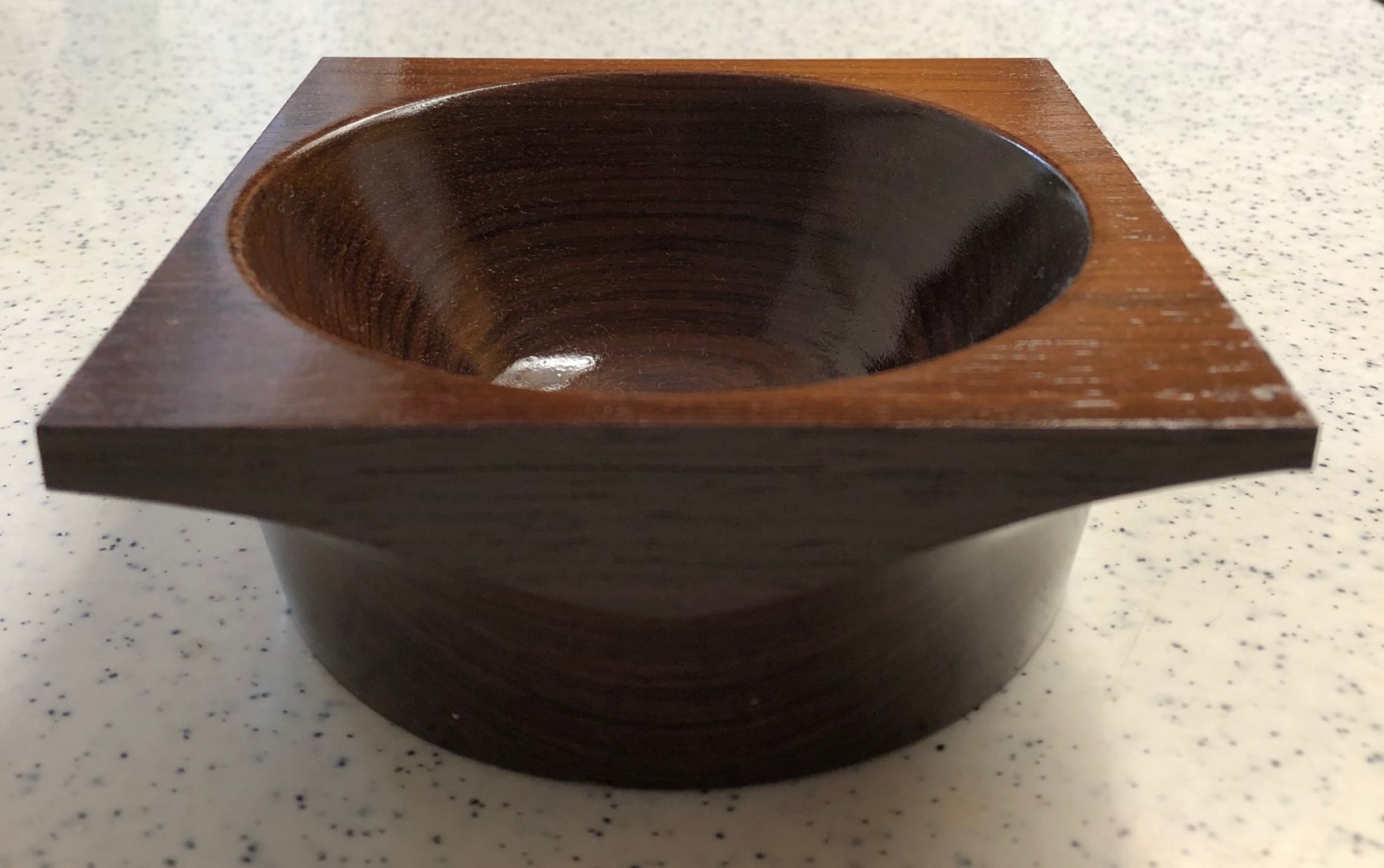

For those interested, here is the finished bowl that I was working on when the catch occurred very early into the turning
Not too bad; the photography is just my iPhone.
