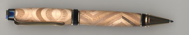

At the Georgia IAP meet last week we had a pen swap and I was paired with Gary Hughes, who had the brilliant idea of using some plywood he had to make a pen. The execution was great and I decided to try some plywood for myself using some plywood from work used for diecutting dies. I glued two layers up then cut the strip at 30 degree diagonals and reglued into a chevron pattern. My wood wasn't as striking a color as Hughes' was but I think it looks pretty interesting.

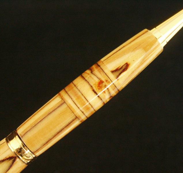

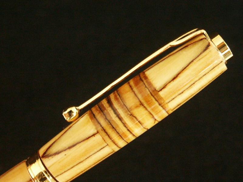

Actually my "plywood" is Laminated Veneer Lumber (LVL) which is a product used in structural applications. LVL differs from plywood in that all the veneers run the same direction where plywood is cross laminated.
LVL is made from plywood veneers and all the veneers are ultrasonically graded to choose very dense wood for it's strength. The piece I used for the pen swap is made from southern pine veneers. Here are pictures of a similar pen with the segmented LVL.
