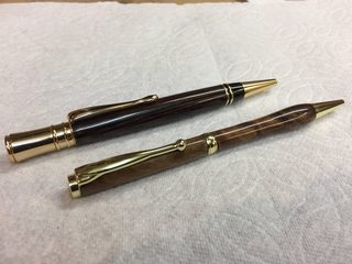

1st post here. Below is a summary of what I have developed as a finishing process and am looking for some feedback as to how I can improve / change it.
Brand new to turning but this is what trial and error has taught me over the last week. Got my best results just last night. Two things have to be smooth. The wood and the CA. If the wood isn't baby butt smooth neither will the CA be. No amount of CA will make bumpy wood smooth. Like the old photographic analogy, you can't get a clear picture from a fuzzy negative.
Thanks in advance.
Sand from 80 to 600 using abranet. Don't skip grits.
Apply 3-4 coats of thin CA to fill any spaces (I might try Med CA for this part next time)
Sand back to 320 or wherever you need to to get rid of anything that is still shiny from the 1st coats of CA. Then you know it's smooth.
Sand back up to 600.
Wipe with slightly damp paper towel.
Apply 4-8 coats of thin CA. (some advocate for med CA for the final coats but I find it to be too hard to smooth out) Sand the CA to 600 again then use wet microfiber pads through 12K (I've found that the micro fiber pads won't smooth the CA enough so that's why I go over it with the 600)
Use EEE ultra shine abrasive wax (2x's if needed) (I tried using auto polishing compound but it didn't work as well as EEE)
Apply friction polish (DIY mix instead of $32.95 for Shellawax)

Thanks. Great advice. For instance, I turned a few pens last night and it seems a lot of my issues stem from using medium thickness ca. Seems like using medium might be a good idea after the initial raw wood sanding or maybe even after just up to 320. Then use 320 or even 220 again to smooth the whole thing out before going to 400 & 600. Then use 8 coats of thin before going to the micro abrasive pads. Medium just seems to make me have to do more sanding to smooth the whole thing out again. I also seem to get better results with paper towels vs using plastic or tape on my finger. Seems to flow better. Tonight I'm going to compare EEE to Plastx, but it still seems that the friction polish gives that glass like finish as the final step. Thin also seems to play better with activator than medium does.
Like you said, I'm just trying to get to something that is consistently repeatable.
