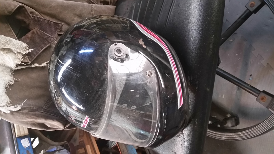

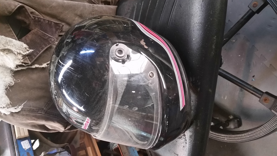

My wife went to a garage sale today and got me something for when I head out to the shop.
At least she has a sense of humor.(She married me, right).
