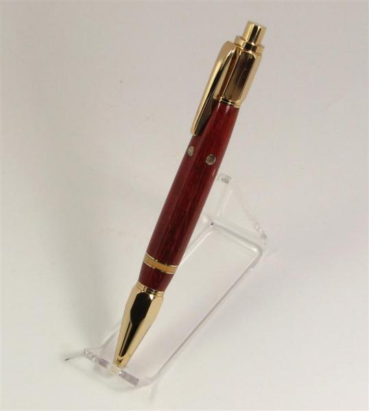

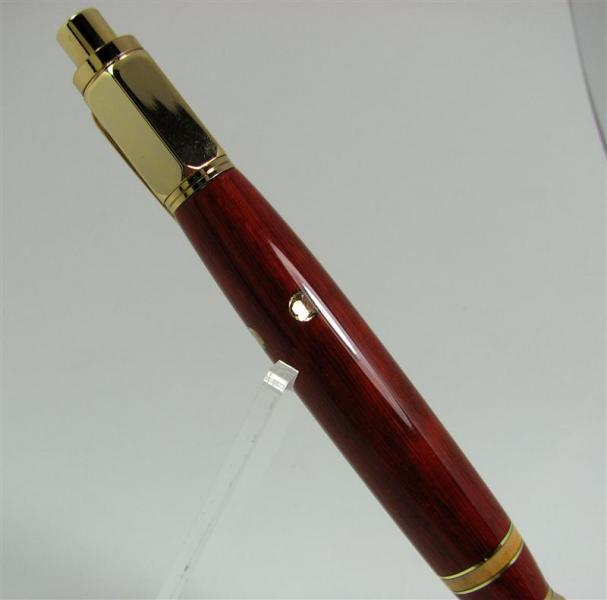

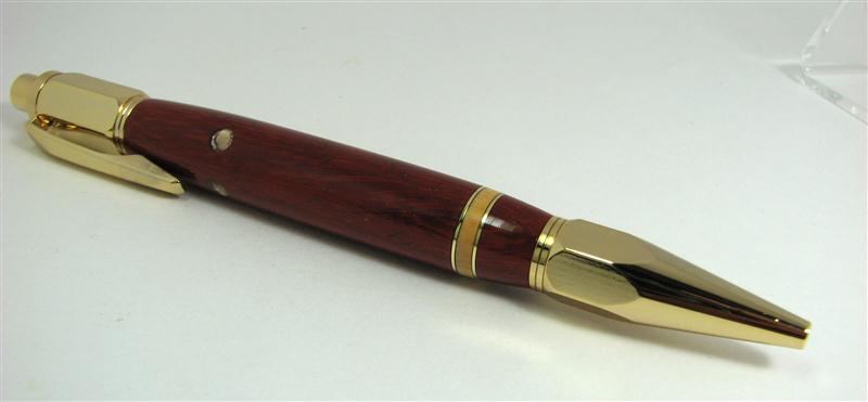

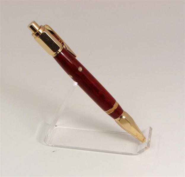

We were wandering through Michael's the other day and Chrissy spotted the wall full of little plastic jewels and decided to play around.
These are 4mm spaced evenly around the barrel. We learned a few things that will be done different next time and I think I nicked the tops of 2 of them when I was turning down some built up CA. They have a little white spot on them that looks like a scrape from the chisel.
For a proof of concept, I think I like the possibilities this opens up.

These are under the CA and you can't feel them. Had an issue with depth though on this kit. I ended up at the brass with the holes and they were still a bit proud so I had to build up the CA along the length to flush them in.
Oh yeah, the main body is padauk with maple and copper (or brass, not sure what she used) segmented in.

I like the embedded look on that. I also like the inlay you did too. I think you have something very cool in the works.
BSea
Dec 28, 2009
4,628
Little Rock, Arkansas
I think the accent ring with brass looks great with that pen. I'm not much of a jewel fan though. Still it's a cool idea that can be done with a variety of items. Great job!!

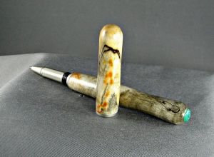

Here's one I did a looooong time ago....
It's not a jewel but rather a piece of Malachite, you can buy them in many different diameters.
