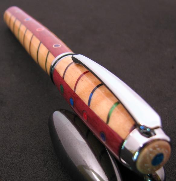

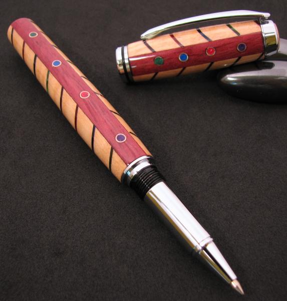

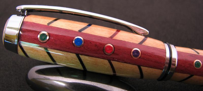

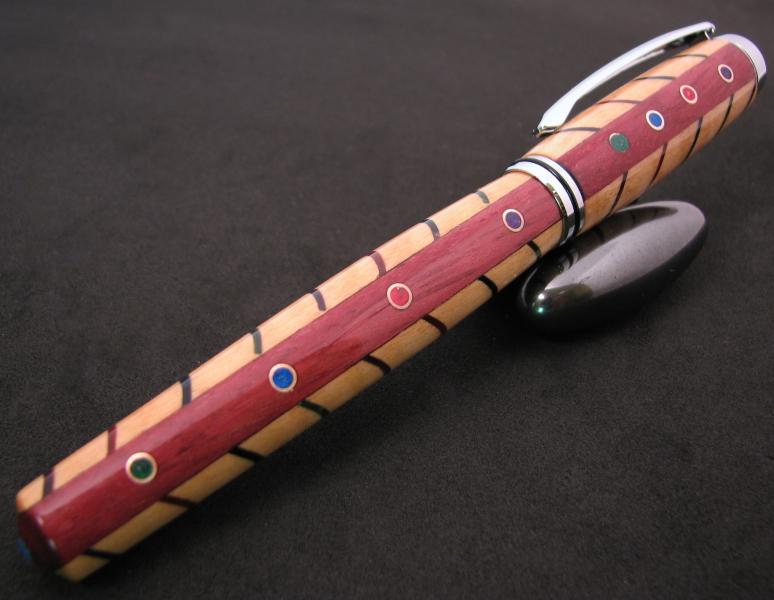

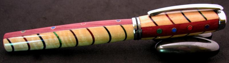

My wife said I needed to use my guitar picks that I bought on FeeBay. I decided to cut a V shape through the Fiddleback Maple with the scroll saw at 1/4" spacing and alternate the 4 colors. I then ripped the blank down the middle and glued a strip of Purple Heart and place some small dia tubing. After turning to near the shape I wanted I filled the holes with the same colors as the picks are. The over glue and mica are the scewed off and the 10 coats CA and deep and light scratch compound. That is about it Im thinkin.
Comments bad or good always welcome.

Absolutely love it! I like how the angled pic segments draw the eyes into the dots. The contrast in colors is great. There is the slightest misalignment in the dots on the cap. This really lends itself to a black and white version that would look like a tuxedo.
