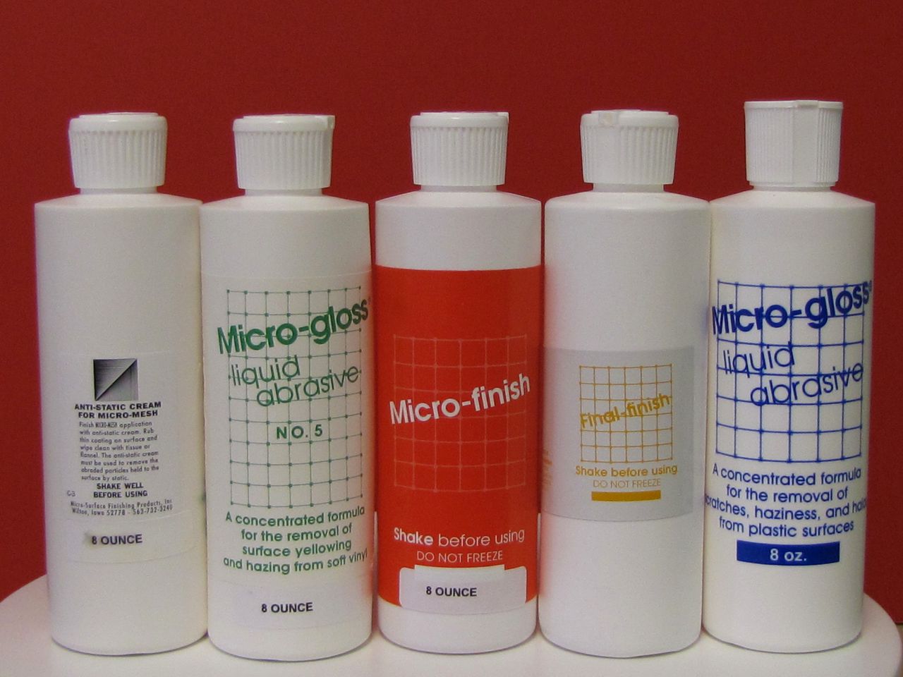

I've been using the Micro-gloss 5 and Micro-gloss for years now. No issues and it's made by the Micro-Mesh people.
