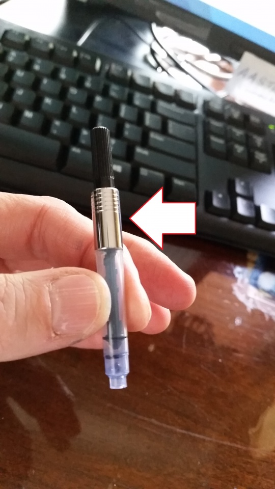

By "didn't fit", did you mean it was too long? Or was it something to do with the nipple?
Thank you both for your questions and insight.
The converter fits into the section and feed without a problem.
It is the chrome-finished "sleeve" that is too wide for the inside diameter of the barrel.
As I mentioned above, I have the converters that came with my kits. I was just wondering why this one which came with a store bought pen, didn't fit. I thought there would be some type of standard among pens of a similar diameter and design. The store bought pen is this: Nemosine Singularity Granite Fountain Pen | xFountainPens

There is no "standard" so to speak between the various pen manufacturers, as they will most likely have their own proprietary converter. As Duncan said, the Standard International fits most kit pens.
Meisternibs - Accessories
Here is an example of several different brands of converters. From left to right: Pilot, Montblanc, and Standard International.
You can see they vary dimensionally from one another.

One other thing to watch is the length of the converter--even in the case of pens designed to take international standard cartridges. My son was building some El Grande's a couple of years ago. Woodcraft furnished a converter with the kit, but the Schmidt K5 seemed like an upgrade, so I gave him a couple. The Schmidts fit the nipple of the feed just fine, but turned out to be too long for the kit.
By the way, the K5 is the unthreaded version
I have the same problem with the Schmidt K5 in my Baron fountain pens.
I found that I could get it to fit by sanding out the inside of the section end of the barrel. I used my dremel with the small sanding drum.
