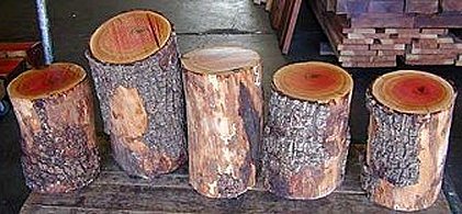

Here is a picture of some pink ivory log sections. One of the reasons it is relatively scarce is because only a small portion of the log or branch is actually pink.
