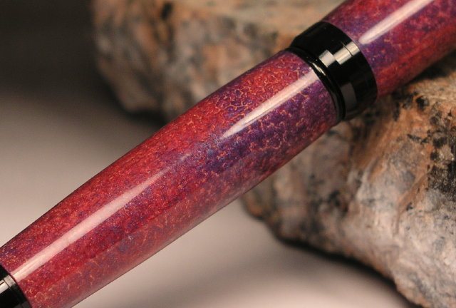

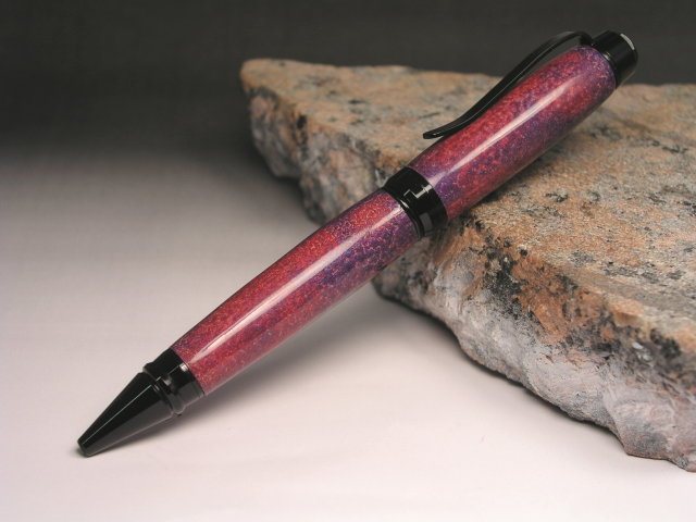

I had a strange dream last night. I dreamt of a pink and purple lizard that ran under my closet door. When I woke up, I found this pen lying on the floor. :D It has a ton of depth to it that I had a hard time capturing in the photo (As usual for me).
This one was a hoot to make. Any ideas what I did? Not too big of a deal really.
Here is a closup of it's Skin!

Very nice James! Looks like the skin is 3D, so I'd guess it's real, and that it was dyed purple. The pink is a pink PR. Am I close?

I'm with Lou. THe first thing I thought of was a pink and purple crackle paint on the tubes encased in clear PR. Nice looking pen regardless, James. I think the black was the right color for it. [^]

It is wood. Well at least underneath. [;)]. I had to do something to spruce up an ugly piece of yellow heart that I had.
As Anthony knows it definately isn't resin. My last attempt at a clear cast ended up in a melted pile of goo when the plastic container melted from waaayyy too much heat. (Too much hardener I guess). I think Lou was closest with his guess at the crackle paint.
Anyway here goes... This is what you need:
The pen started out as a Yellow Heart Blank. I turned it to size as normal (A little undersized actually). Then I took it off the madrel and applied a light thin coat of spray adhesive. I then coated the blank with three different colors of Embossing powder into a patchwork type pattern. Then I torched the little bugger until It flowed where I wanted. The texture was great, and pretty easy to control. Then back on the mandrel for a thick coating of CA to smooth it out. Then my usual polish and buff with White Diamond. I like the results.

WOW! COOL idea James! I never thought about heating the embossing powder to make it more solid. I wonder if you can generate enough heat by friction without it sanding away.
VERY nifty design!
