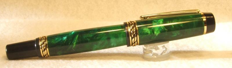

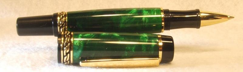

My work pen is an Olympian Elite2 from PSI, They have a starter kit
www.pennstateind.com/store/PKOLFREE.html That gives you every thing you need, and I have switched the regular refill over to the V5 X FINE #77273.
I get them at wal-mart 2 for $3. I have found that these will interchange with just about any of the pens that take the german roller ball refill. It is a gell refill also. www.pilotpen.com :)
