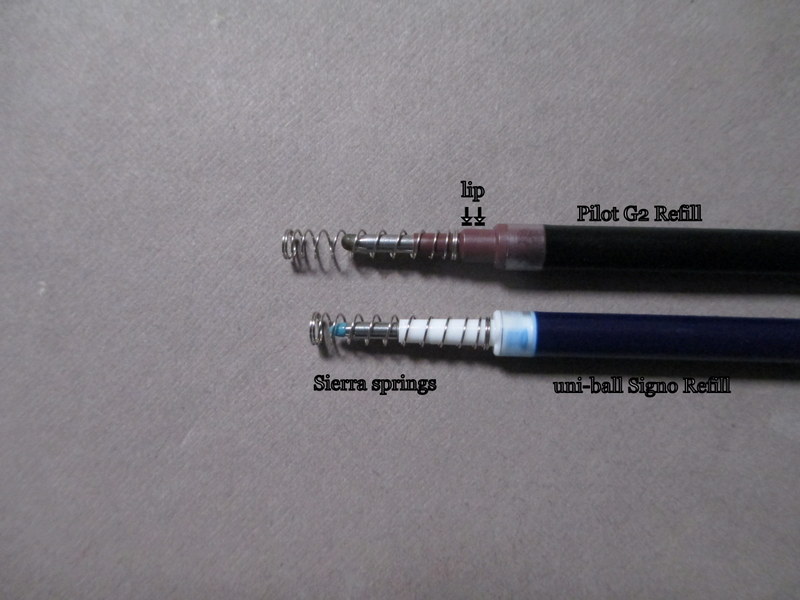

I done it with Senna click, and the new Sierra click from Exotic Blanks, you have to up size the brass tube,the senna length end up being 2.770'' you can buy the longer brass tubes for the Sierra family can't remember if they 10''inch long or 12 inches i will have to check where i got the mine
brass tube 10 inch 27/64 i got mine from WoodturningZ The uni-ball Signo refill has a better nib end to fit the spring too a strait end no lip.The G2 Pilot has a bigger lip where the spring backs onto its easily fixed by cutting the spring or change the spring out for a bigger one to go over the lip.

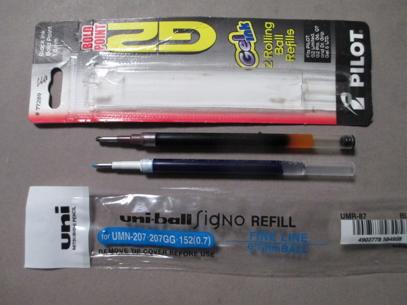

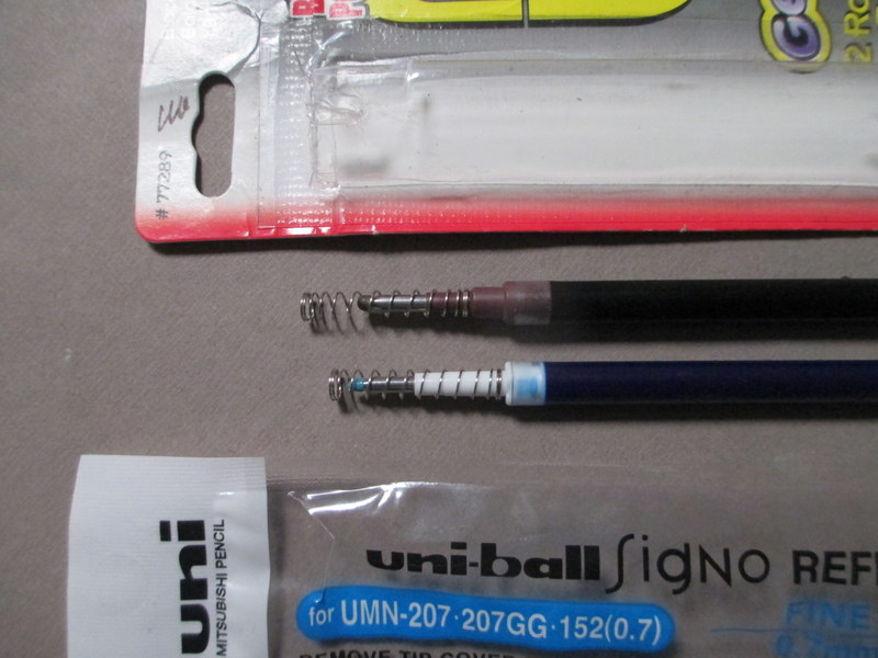

Pilot G2 question
Here is photos of the different refills with the G2 and Sierra springs
The Sierra spring works well on the uni-ball Signo refill
G2 will need a different spring to work right.
Both refills write well uni-ball Signo my favorite

Another point i would like to make is,the Mod for me was just a refill/click testing thing with different kits and for my own use, cutting springs and changing blanks is not for all, Now
The Senna will take both refills with just a longer brass tube and blank,
The Sierra will take G2 pilot with spring cutting Mod and longer brass tube and blank,you can add another Mod to fit the Uni-ball refill into a Sierra this is done by using the (G2 Refill black end cap) doing that Mod is less spring drama,also when Senna click is in writing position the click button moves in and out, it's works the same with a PARKER Refill. have others found this problem This does not happen with Sierra click unit,
