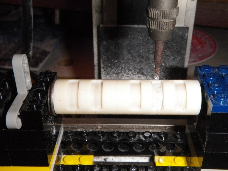

Here is a pen I made for the woman I love, Cristiana, of course she play piano (very well...)!
Alternative Ivory, Rhodium Gentleman. I'll change the nib later, for a better one.

Thats a beautiful pen Etienne. I see you have done the inlay on the body yourself. Did you do the cap inlay yourself as well? What is it made of, acrylic? Did you shape the inlay after putting it together or before inserting?
And dont knock the nibs, they're not too bad unless youre going to upgrade to 14K or 18K.
Thanks for sharing.

I had made the cap inlay myself too, with the milling machine Proxxon MF70, for the straight lines, and by hand for the rest. I'd put charcoal with CA glue. The inlayof the body and cap was made with the tube inserted.
Of course, for the nib upgrade, 18K .
Material is alternative ivory, and small piece of 'lego' for the black keys.

i just had another look at the first photo are they leggos you used to set the blank up, that is really cool first time ive seen that done.

Very cool. And that has got to be the most creative use of lego blocks I have seen in a LONG time.

Outstanding!!! I agree, most creative way to use leggos I've seen.
