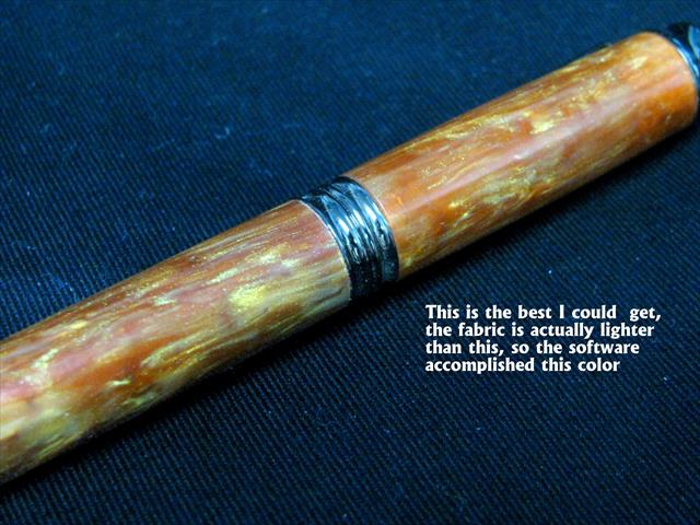

I am so glad we have the Exotics' forum, because a whole lot of vocal people will say this is an ad. In FACT, I am interested in some direction from those of you who do photography well.

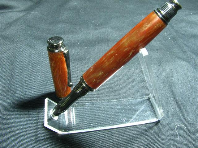

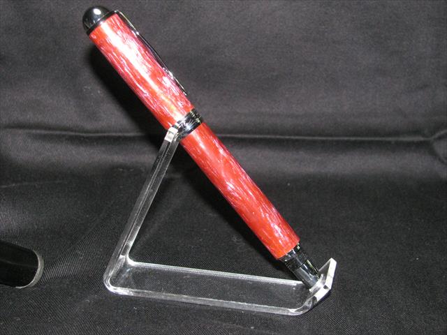

I turned these "Maj'K" blanks easily and got the pens with gunmetal plating, thinking I would have less trouble with flashback from the components and should be able to get good pics of the color effect.
I am NOT impressed.
After trying my usual (two photo lights--florescent, above the product by about 2 feet, on either side)--I realized that was only going to give me "white" in the sections where the "color shifting" was taking place. I SEE this as a purple-blue color, but the camera sees it as white.
I changed the angle of the lights, placing them behind the blanks, so the reflection was minimized. That's how I got these photos---which I consider the best of the poor!!
I have tried changing the "f-stop"?? (the number from 3 to 8 on my camera) While this changes the darkness, it does NOT change the white to a color. I tried using the flash---not impressed.
The only thing I did not try (because it was night) was filtered sunlight.
Any other ideas???
AS you may have read, EdD is offering a free six pack of Maj'K blanks to the person who submits the best photo---I'd like to help people succeed!!!
Thanks for any input!!
Ed B (ExoticBlanks)

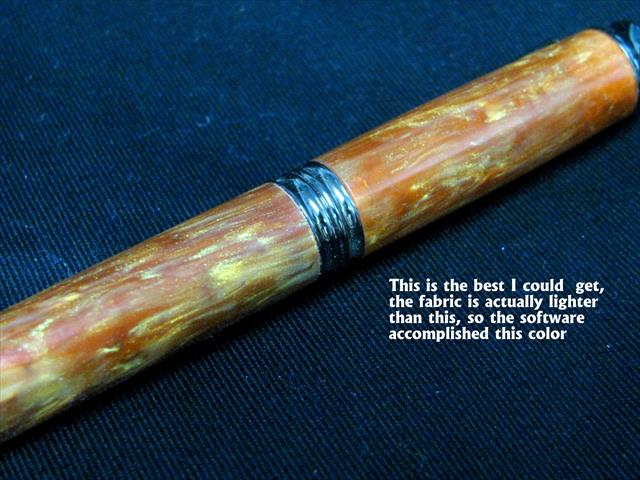

They are the same pen on the same background piece. A light blue denim. The second picture portrays the color accurately. The first picture was "photoshopped" to try to make the color of the pen more like what my eyes registered the color to be.

I've not seen one of the Majk blanks, so I'm at a bit of a disadvantage, but listening to what your wrote (or reading what you said (particularly between the lines) :biggrin: I think I would try using very soft diffused lighting and longer exposure on a tripod.
I also decided to play with your photo a bit, taking into account your first two photos. A lot more could have been done if starting with a "raw" format file rather than a jpg, but what the heck. Here's a quick and dirty shop chop. How's this compare to the real thing?
Maybe you need to rethink trying to get a single photo that captures the essence of Majk and instead create a short video that shows the blank moving in light. Or you could create an animated gif that would accomplish the same thing but that might be more suitable for web page adornment.
Just some thoughts.
