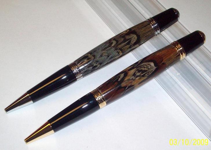

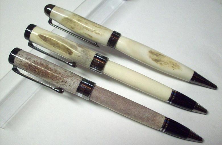

These Sierra pens were made from Ringneck Pheasant Feathers that I casted after being inspired by Shane Whitlocks work. The other three are Whitetail Deer antler. I am currently making a group to donate to the Illinois Taxidermist Association next weekend for their raffle and fund raiser, and as gifts to some of the guys that give me antler.
The Sierra's are a little thicker than I like them, but I wrapped the tubes in black paper then applied the feathers, so the base was a little thick before the resin and some of the feathers were getting close to the surface. Something to work out for next time. All comments welcome. Thanks

With the black paper background, did you apply the feathers the same way as Shane?

Very cool. Do you glue the feathers to the paper and then wrap the tube? How ever you did it, you did good.
I did it a little different than Shane. I scratch up the tubes like with all blanks, then I cut small pieces of black construction paper and coated one side with Elmers Super Strength stick glue and wrapped it on the tube. I let it dry for about a half hour while selecting the feathers. Then I start at the top of the tube, working my way down, using the same glue stick on the back side of the feathers. You have to hold them on for a minute but once they stick, they dont move. I overlap them from top to bottom and trim off the access feathers after they dry. The rest is like casting any other tube, rubber corks in each end, filled with BB's, and glued to small 1/4" ply to hold them up in the molds.
I used feathers that had been dryed for about a year in Borax so they weren't greasy. Not sure if fresh feathers would make a difference or not. Good Luck!
