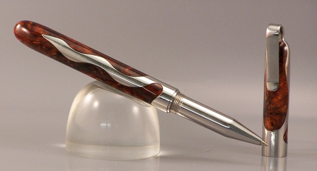

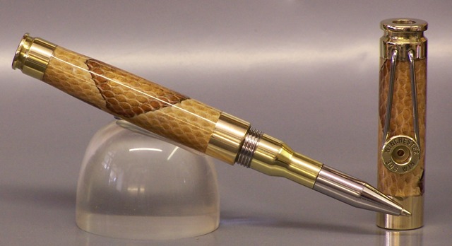

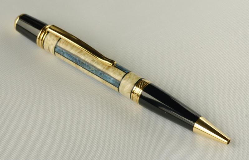

Pen turning, crafting, making covers a far wider range than many people new to this hobby/profession - would believe. For me, it took me 1 1/2 years to make consistent and predictable finishes on a pen. And some people do it right the first time! :rolleyes: Jump in and have fun! :biggrin: That is the main thing!
There is room for all and ALL types of turners here.
There are many people that make a good income selling the $35 - 75 pens. But many of these do on occasion sell a $100 - $200 pen. And those are often custom orders because of a previous sale and the buyer recognizes the quality of craftsmanship and artistry in the lower ends ones. If the quality is there in the lower ones, the higher end sales will usually come.
Look at the pens below; These don't even scratch the surface for the number of high quality fine writing instruments and works of art here. After looking at those, do a search of pens on this forum. Some fine work here.
http://www.penturners.org/forum/attachment.php?attachmentid=4268&d=1228940584
http://www.penturners.org/forum/showthread.php?t=35679
http://www.penturners.org/photos/images/3090/1_Casing6.jpg
http://www.penturners.org/photos/images/5346/1_Hbone.JPG
http://www.penturners.org/photos/images/3090/1_25.jpg
