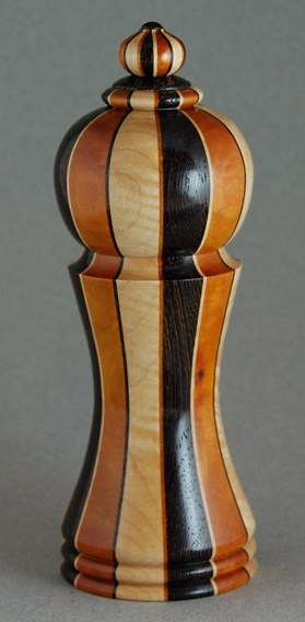

This is the peppermill that I had up in Racine, WI a few weeks back when I went to visit Ed and Dawn at exoticblanks. The adjustment knob is a chunk of leftover pen blank (Stripe Tease blank). The inspiration for making my own adjustment knobs came from a critique that Jacques Vesery and Bonnie Klein did on my peppermills at the 2009 Ohio River Valley Woodturners Symposium. They commented that I should really get rid of the "Industrial Looking Chrome Knob" to make the peppermills truely unique. This is what I came up with... Jason

Looks great. How does the adjustment knob attach? Or did you just cover the chrome ne?
Chris
I purchased some little brass inserts from MSC and epoxy them into a .250" hole in the pen blank. They are small knurled brass inserts used for plastic injection molding. I origionally tried making the knobs by epoxying the chrome knobs into a pen blank but they looked too bulky. The brass inserts are really small and give me more latitude over the overall shape. Jason

Fantastic job, every time we can devise a good looking diversion to the standard kit fare we raise the bar and make a really good impression.

BTW: Jason, That is one impressive pepper mill and one great idea. I've made a couple of pepper mills where I had filed down the nut, buried it in a piece of wood and carved it to look like a wing nut. It looked good but your design is much more sleek and attractive.
