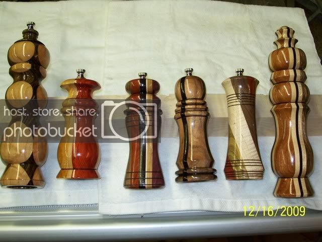

Whew! Just finished my last peppermill gift for this Christmas. I think I did about 10 or 11 in the past 4 weeks which is a lot for me since I don't get much time in the shop...
Anyway, here's six of them...The 4 smaller ones (6") are for gifts for my daughter's teachers and the 2 large ones (10") are for my Mom and my Aunt.
Lots of woods used in these...Redheart, canary wood, cherry, maple, walnut, Lignum Vitae, Purpleheart, Brazilian Ebony, Sapele, Koa (I think), possibly marblewood, and bocote...
comments welcome!!
Thanks for looking!!
Jeff

Very, very nice, Jim!!!
The design of the bloodwood and canarywood (#2) is very unique. Did you "originate" it? I do like it, just have not seen it before.

Those are all beautiful. Nice color combinations, outstanding finish, and elegant shapes. My favorite is probably the 3rd one from the left.
-Barry

Ed to answer your question...I guess I'd have to say yes and no. While I did not come up with this design from plan, it certainly as inspired by others that I've seen. I've looked at many many peppermills on the internet and in magazines and books, so I'd have to say the while all of these designs are my own, I probably didn't invent them...I normally mount the wood on the lathe and have a very loose general idea of the final product. then I just start cutting and see where it takes me!
As for the question of toxic wood...If you read some of the wood books, pretty much all wood is "toxic" to a degree and as Ed said, you'd have ingest a lot of wood directly to have negative effects at least IMO. I do normally seal the inside with a shellac sanding sealer though...

I don't mind sharing at all!! The finish is super easy!! 4 coats of Deft clear gloss spray lacquer. Shines up beautifully!! I've also knocked the gloss back on some with the beall buffing system, tripoli, white diamond, carnuba...I personally like the glossy finish, so I haven't been buffing them...3 of these were buffed, and 3 were not...

MANY people (including me FWIW) use the Deft spray for Peppermills.
Although I have switched a little, I apply a coat or two by rag on the lathe first. Have to be fairly light coats, but it lets the wood soak it in a little and speeds the overall finishing time ------ FOR ME!! YMMV!!!!
