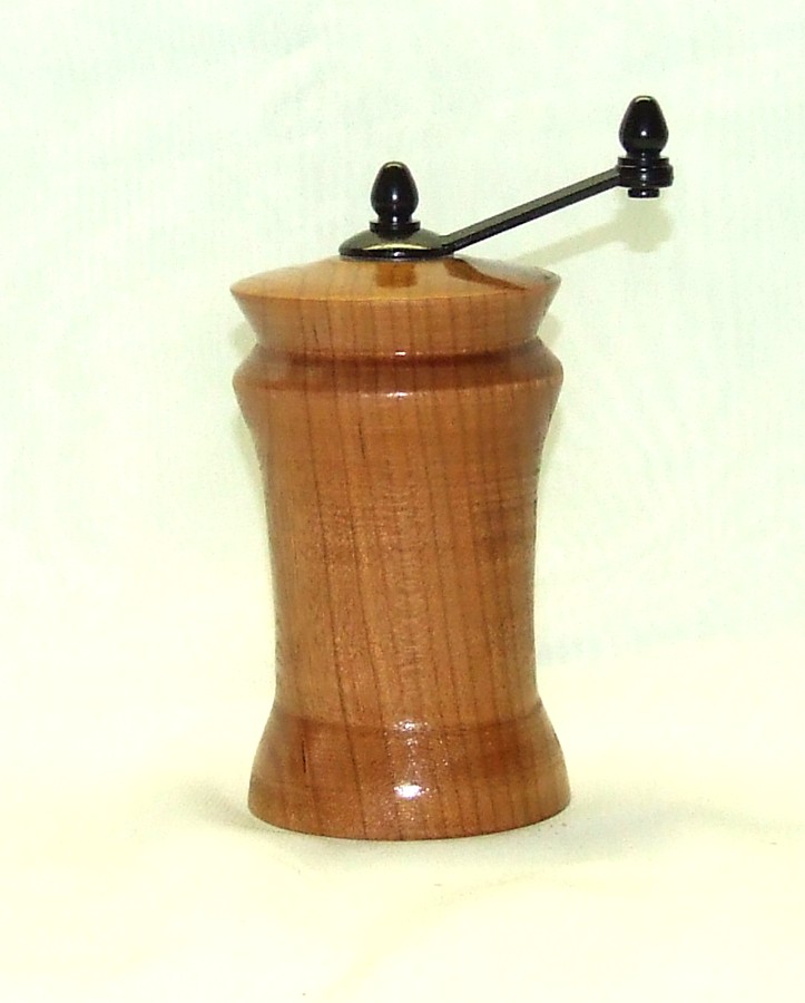

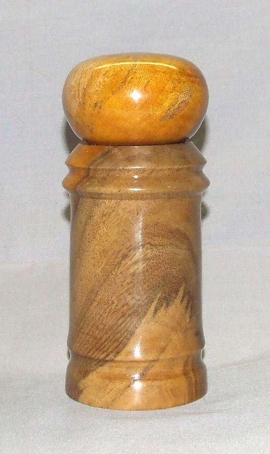

I like the crush grind style of mills... they are a lot more forgiving than those with the top knurl... you can adjust the shaft length on the crush grind to fit your turning... and they're pretty easy to do.
And lately I've had good luck with the little mini crank grinders that PSI and CSUSA sell... they only use a 4" block of wood, so not so much to mess up.
Here's a couple I did.... ok more than a couple...
The only wood I've bought for this batch is the first one 34-1811 ... it's a piece of black olive wood I picked up at my local wood store... the others are all from pick up wood that I've gotten for free from friends and neighbors.

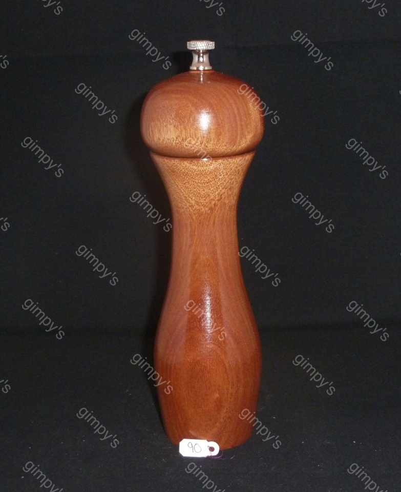

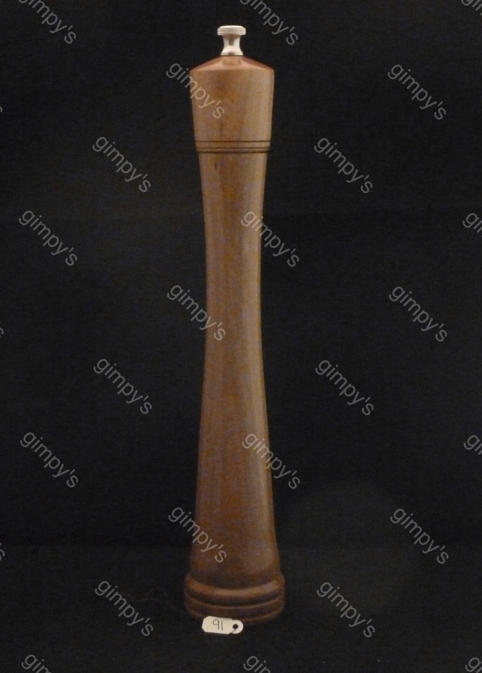

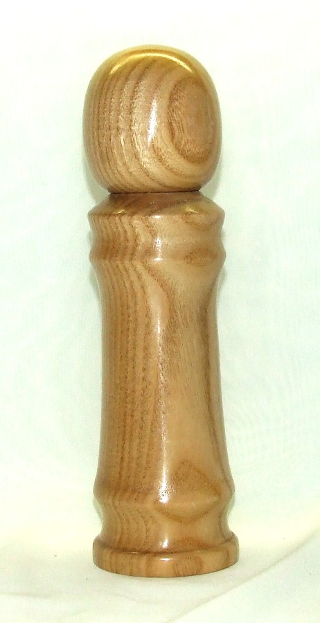

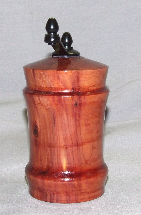

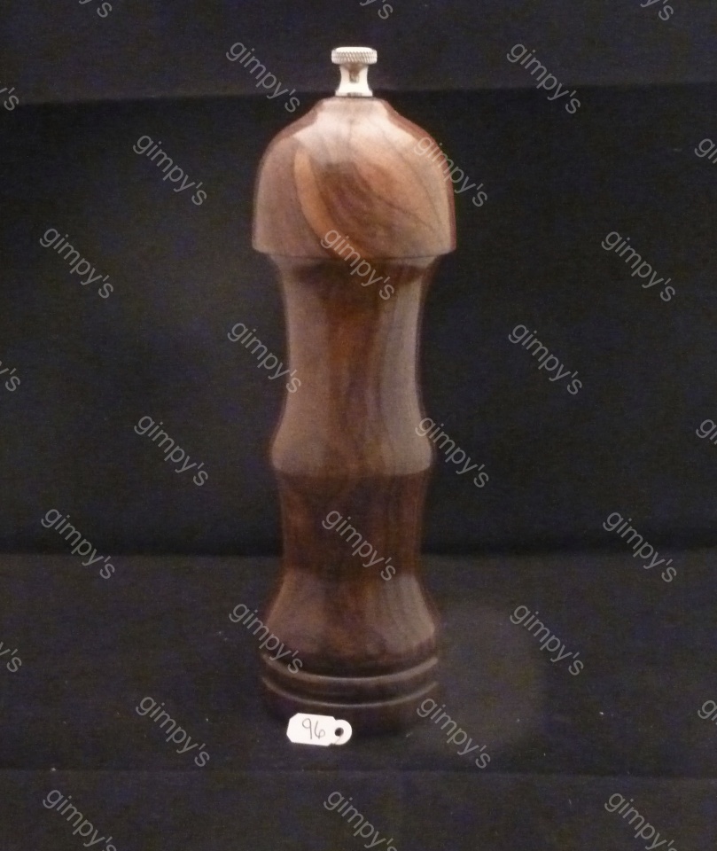

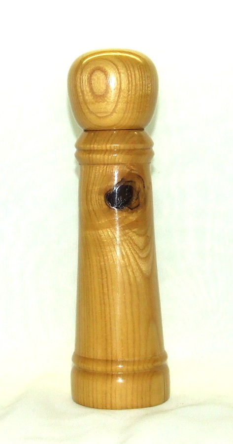

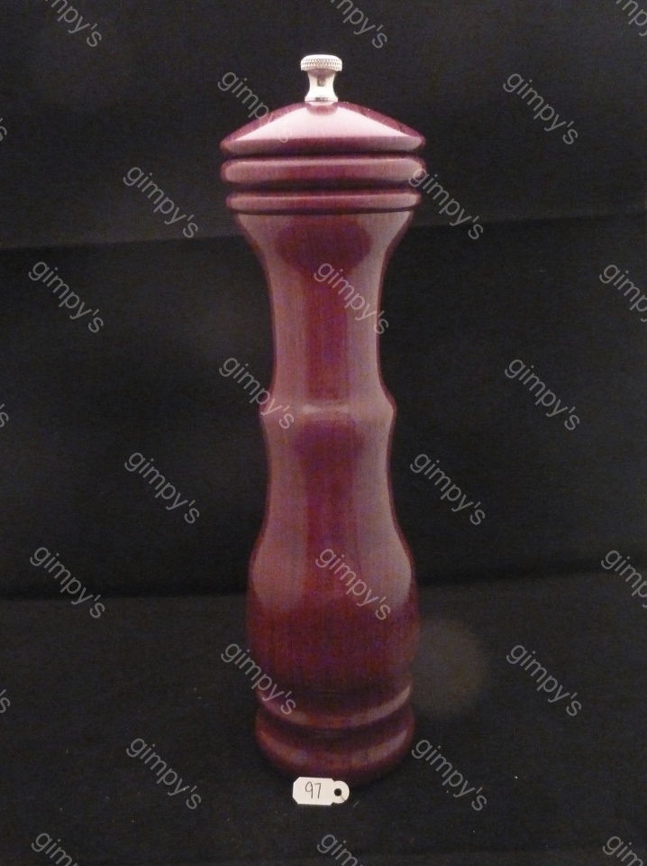

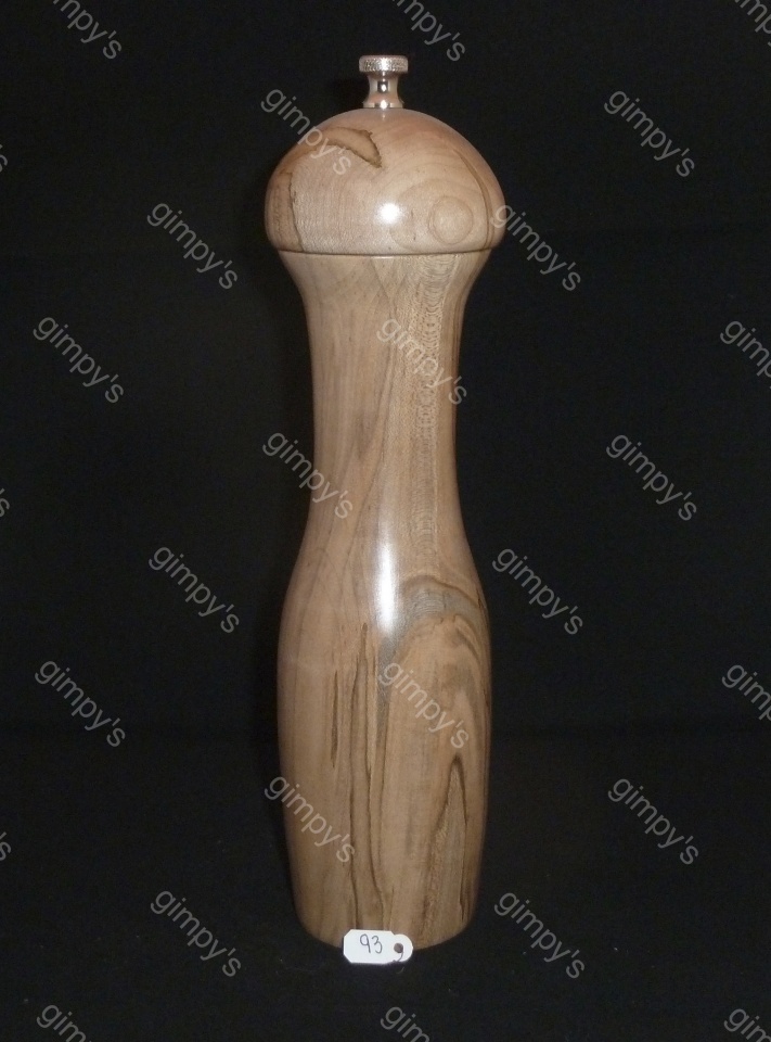

Here are a few I made:
1. Pecan
2. Purple Heart
3. Red Elm
4. Spalted Ambrosia Maple
5. Unsure
