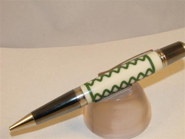

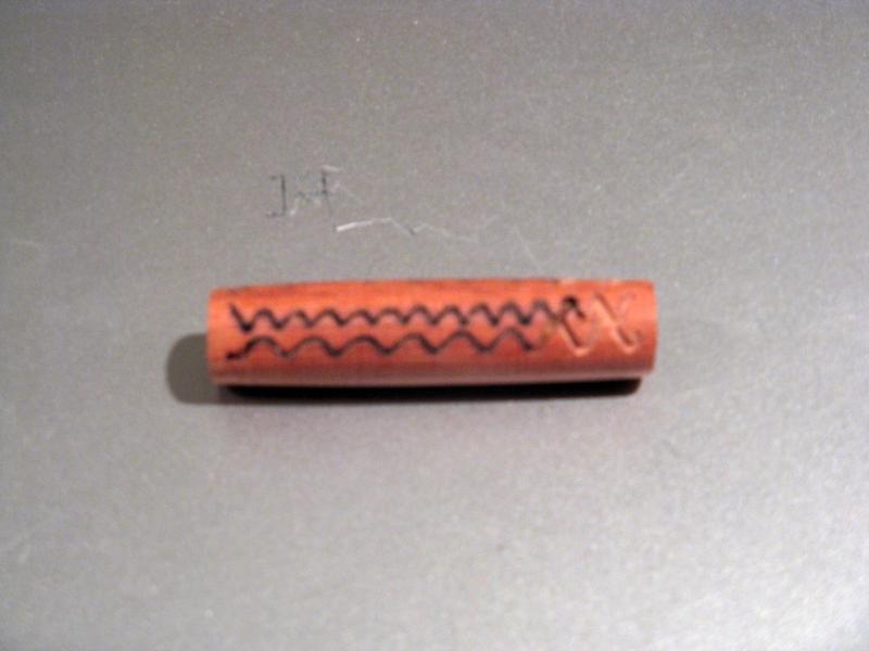

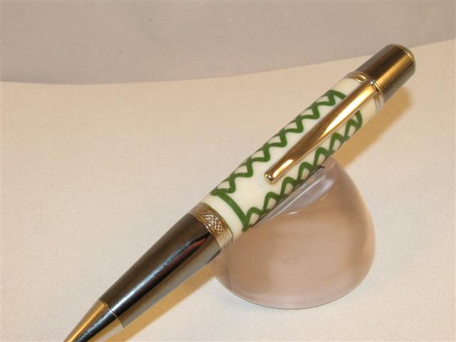

I thought it would be interesting to have the "squiggles" meet, instead of be parallel.
So, here is the prototype. (Some refinement is required)
I believe the guilloche tool operates independant of the gearing. You can adjust the modulation (this was at a middle setting), but frequency is a constant. I could be wrong.
Comments, of course, are welcome.

That's pretty cool lookin' Ed. Is that machine difficult to use? Can you eliminate the little tail marks that are stiking out?

Yes, the tailmarks are a function of "operator error".
IF you adjust the start and stop points with the "lock nuts" that are designed for that purpose, you can make these points hit each other, dead on. THIS pen, I was playing with the squiggle, so I did NOT pay attention. MY ERROR!!! NOT a machine flaw.
