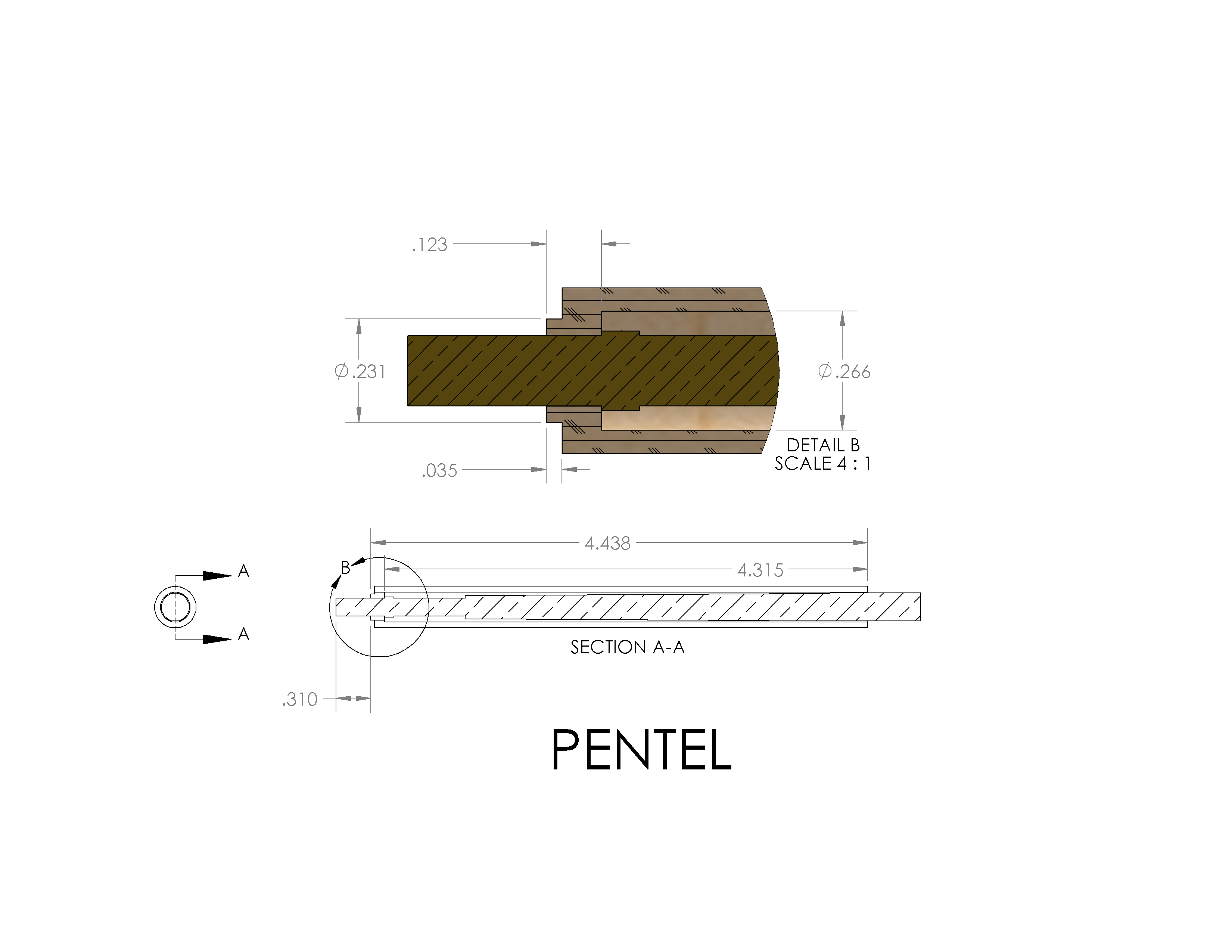

How to.
1) Cut your blank down to 4.60"
2) Drill with the non-stepped drill (you will drill short to 4.315)
2) Drill with the stepped drill (you will adjust the drill stop so the distance from the step to the stop is 4.315)
3) Place the pencil mechanism in the hole, and measure the amount the pencil protrudes. You want it to protrude ~.310", trim to length the block on the front end to get this protrusion. ****Make sure the drilled stepped hole is completely clean, failure to clean it out will give you a false measurement and you could end up trimming too much off.
4) Now verify with the pencil inside the block that when you remove the back cap the eraser is easily accessible, if not trim a bit off the back (total length should be 4.438).
****By drilling short and trimming after you have drilled, you prevent the likely hood of blowing out the thin front end.
****Please use a strong blank, items that have been factory stabilized very in stabilization quality.
View in Gallery
Thank you to all who have previously posted on this topic, this was the only way I could get a quality .5mm pencil for an artist who needs the ability to add lead easily and control it well. All other options I could find were .7mm.

Ok, drawing added with additional instructions to the original posting. I hope it works out for you Mike and any others.
